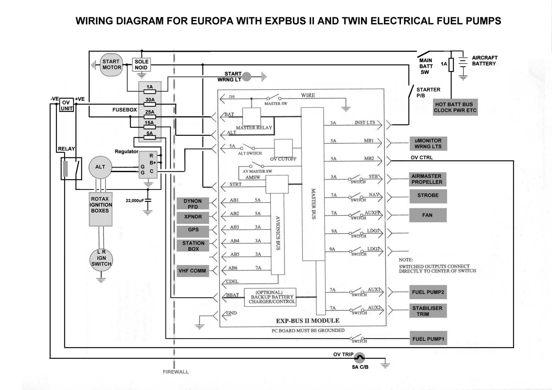

I must be a total retard, I am so confused by the wiring of my 914... help!
As back ground information, I have a Control Vision Corp. EXP BUS 2 with
two batteries.
The current (sic) problem is not understanding how to wire up the
regulator at points R, B+, C. And, what to do with the capacitor. What
size wire, wires? come out of R and B+.
Can anyone direct me to another reference other than the Rotax manual
Thanks, anyone know a good counselor ?
Ralph

Hi Ralph,
If you have are using the rotax standard alternator regulator combination, the R, B+ and C termanals are to be connected together.
Also the capacitor +! goes there.

On request from another builder I produced a diagram for an ExpbusII. I
have slightly downsized the attachment to comply with the forum
restrictions. If anyone wants an original contact me off forum.
Nigel Charles

Oops,
I see what has been in front of me all along. It's tough having ADDS.
The schematic even show the proper wire size... oh well. Sorry, I will
try to have a much harder question next time.
