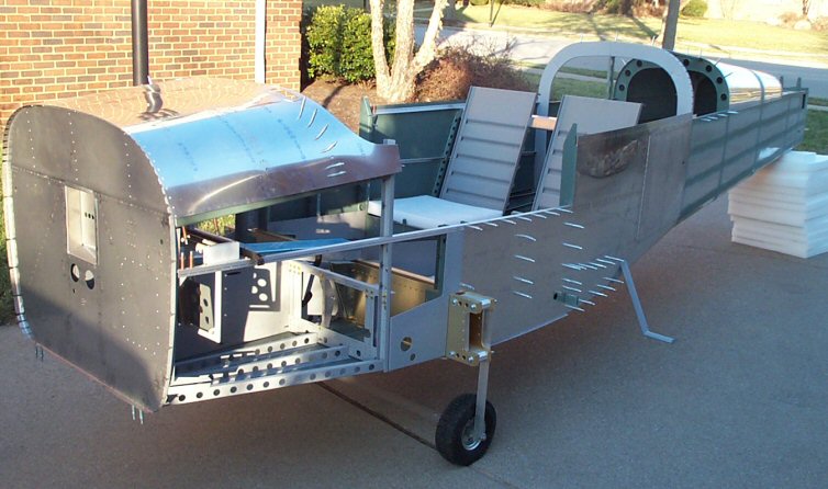

I just moved mine about a month ago. I had made a set of wheels and bolted them to the wing spars. My 16 year old sons and I rolled it onto a 18 foot trailer with 4 foot ramps. I don't have scales but I can pick up the front by myself. The CG in this configuration is somewhere around the front part of the rear seats.
I unloaded it from the trailer by myself at the airport. The wheels were great.
Picture is attached.
These are coming off in the next week or so for the real legs!

<?xml:namespace prefix="v" /><?xml:namespace prefix="o" /><![endif]--> Jim, I want to make something along the same lines. my QB will be here Fri or Sat . do you have a sketch or just deminsions and material used. would appreciate any help. Thanks

<?xml:namespace prefix="v" /><?xml:namespace prefix="o" /><![endif]--> jim, would you be interested in selling them when you install the mains. I am building in the Houston area.

Attached is a set of instructions.
Someone else may want to build a set.
How about we do this.
You pay the shipping and you can "Use" these. When finished they have to be provided to another -10 builder (Who also pays to have them shipped).
I will have to figure out how to box them up.
Provide me a "ship to" address (Off List!).
Jim Combs
40192
