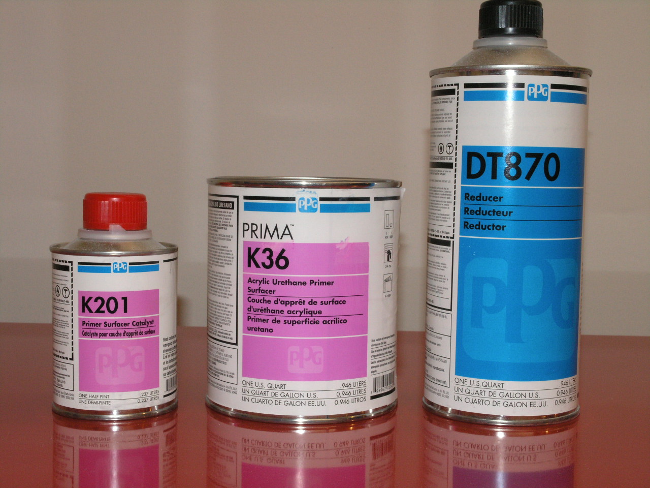

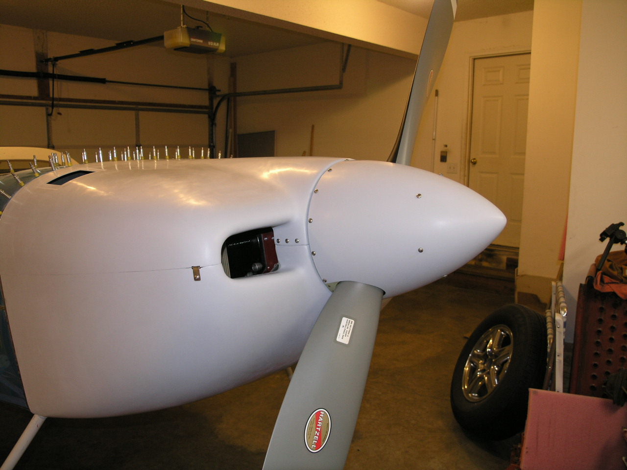

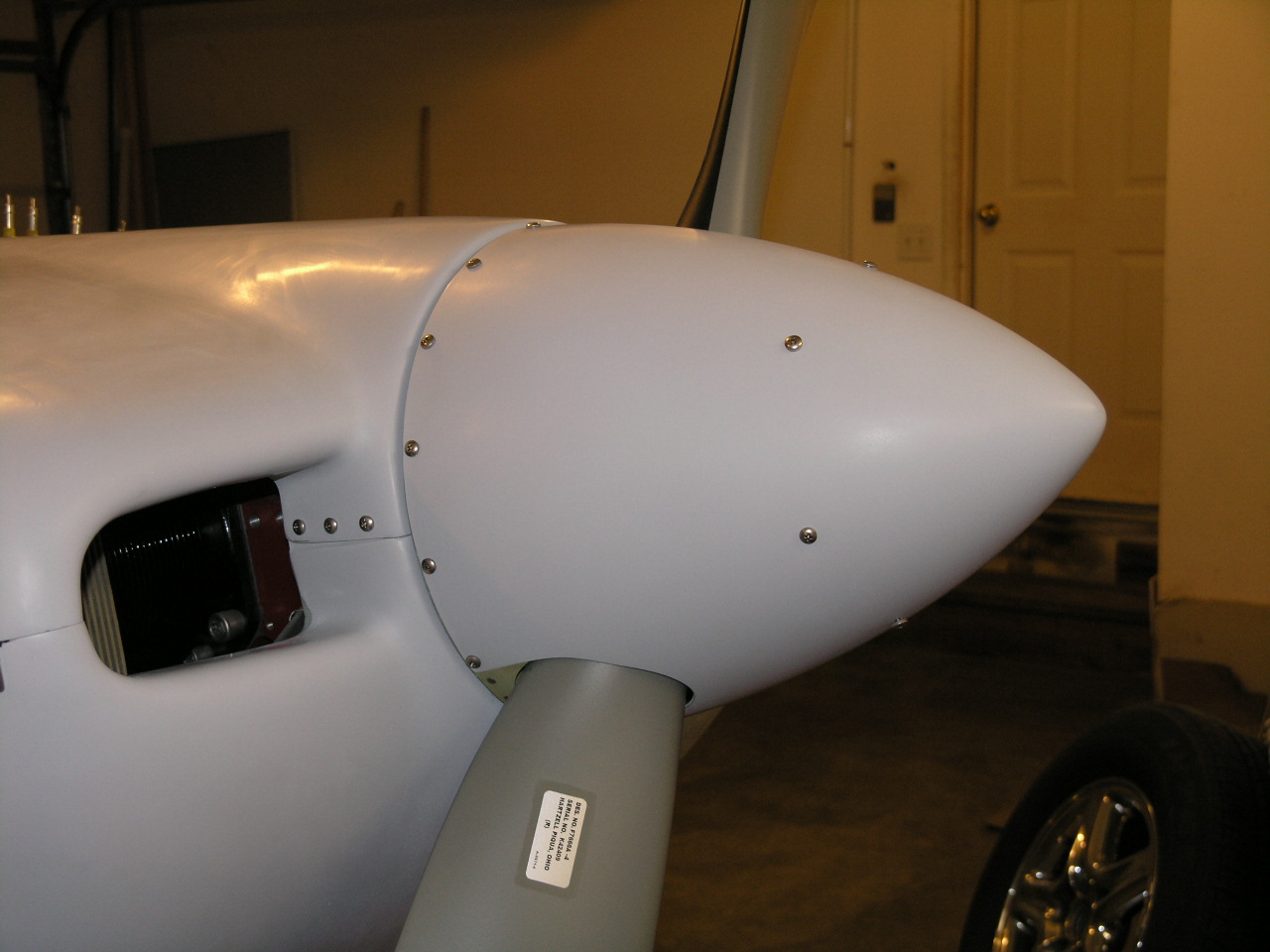

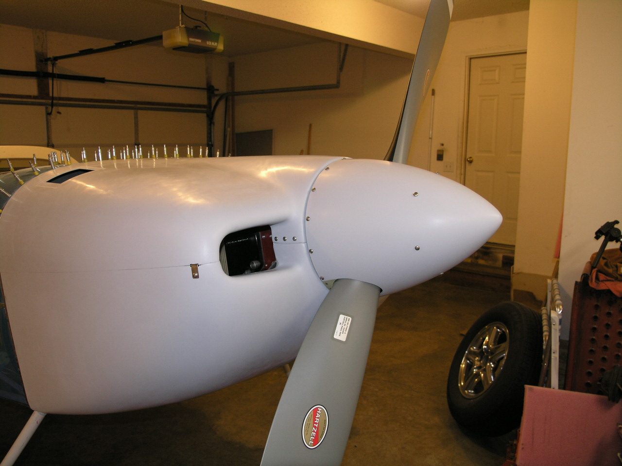

I tried Van’s “thinned epoxy” coatings, but the 24 hour wait before sanding can make this a loooong process; however, it works and it’s inexpensive. After three coats of the thinned epoxy, I became impatient and switched to a primer/filler product by PPG that can be sprayed or brushed on. Attached are a few pictures of the product and the results. I have no experience with the smooth prime product.
Bill
