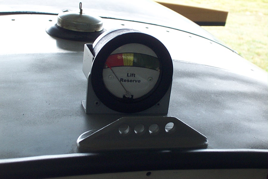

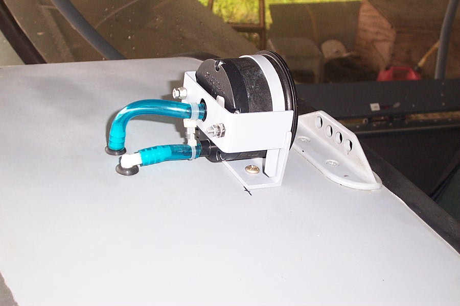

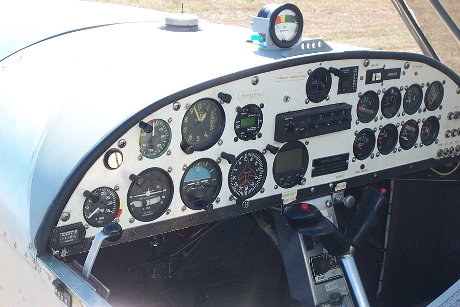

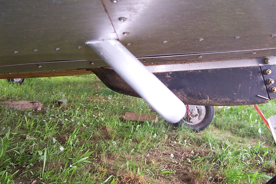

I can't speak to the 701 installation of a LRI but have had a LRI in my
601HDS for almost a year and a half. I posted pictures of the probe and
indicator on Scott Laughlin's website and would not fly without it. My
field is short and rough and I found that my landings were unnecessarily
long and fast. Using the LRI I have shortened the takeoff and landing
distance and cut down considerably on wear and tear on the plane and my
nerves. I highly reccomend one.
As far as being too busy to look at one while close to the ground I
found that it's THE most important instrument to look at close to the
ground. I mounted mine above the instrument panel so it's in my line of
sight as I look out the canopy. A few ex-military pilots recognize it
but almost all GA pilots are clueless as to it's function untill they
see it in action. Total cost was less than $80 or so. Only downside is
that the Dwyer differential pressure gauge used on mine as in indicator
is an odd size-- I guess 3 or 3 1/2 inches so it's hard to put in line
with other instruments. I have seen expensive and complex digital
models that illiminate sequential red or green LEDs but I like the
analog needle that gives immediate feedback on wing's lift. I installed
it to let me know when the wing was about to stall so I could land
slower but found that it's just as handy to lift off short in ground
effect and watch the lift available rise to a safe level before rotating
and climbing out Works just as well to give warning of an impending
departure stall or if you do a high speed turn or chandelle it lets you
know what the state of lift remaining is.
If you ever fly with one you won't be without one. Just don't stick it
in a corner where you can't see it easily.
Ron

rdewees(at)mindspring.com
PostPosted: Tue Jun 06, 2006 7:47 am    Post subject: Low speed takeoffs and stall Airpseed. LRI Reply with quote
Hi Bill,
I read your post about the device you made to get under the panel.  That's a great accomplishment.  I couldn't find a shoe horn that large so I just squirm in.  I've spent way too much fun on my back with my feet over my head and it wasnt' even an indecent situation!
  I don't remember the source of the plans for my LRI except that I got them from Scott Laughlin.  I will send him an email and ask him to post the link.  He was turning out the probe ends and mentioned that he was set up to do others so I bought one from him for $40.  I think I could make one now tho.  It's made from alumimum bar stock 1/2 X 1 1/2 inches and about 10 inches long.  THere are two holes drilled lengthwise almost all the way thru the bar but edgewise holes from the front are drilled to meet the long holes.  Much like a second pito-static system.  The probe was mounted to a wing rib that forms the inside corner of a baggage locker.  I routed the small plastic tubeing inside the lightening holes of the ribs and up the inside of the fuselage.  There isn't any electicity involved unless you want to put a POST light on the gauge.  I'll look for pix too.
 Ron
a baggage locker.
I decided to mount the LRI probe and pitot/static probes on oval
metal plates similar to the one used to access the fuel
strainer. That allows me to remove them while moving the wing around
in my shop so they don't get broken off.
Paul
