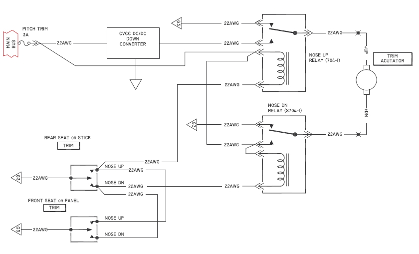

How about this one?
Rated for 8A (plenty of headroom) but
in addition to an adjustable output voltage
(controls speed) there's an adjustable
current limit (controls inrush).
Use this dc/dc converter upstream of your
dpdt center off polarity control switch.
Set voltage for max desired speed. Then
set the current limit to some benign value
well above max rated load for the actuator . . .
say 3A.
PostPosted: Thu Nov 14, 2013 10:29 am    Post subject: Trim motor speed control Reply with quote
[img]cid:7.1.0.9.0.20131114122807.01f1ed78(at)aeroelectric.com.0[/img]
 Filesize:  81.99 KB
 Viewed:  22482 Time(s)
