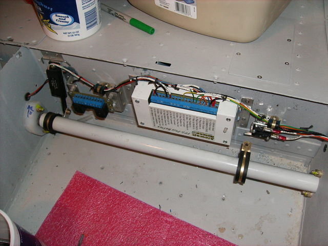

PostPosted: Fri Oct 11, 2013 8:36 am    Post subject: Re: Flap positioning system Reply with quote
Here's where I mounted my flap controller. The photo is a bit dated, but close enough.
The only thing in the tunnel is the motor. I've inspected this area several times since phase 1 and it's pretty easy to get to.
I also have the flap safety trim system, but it's mounted on an under panel drop down tray on the copilot side.
