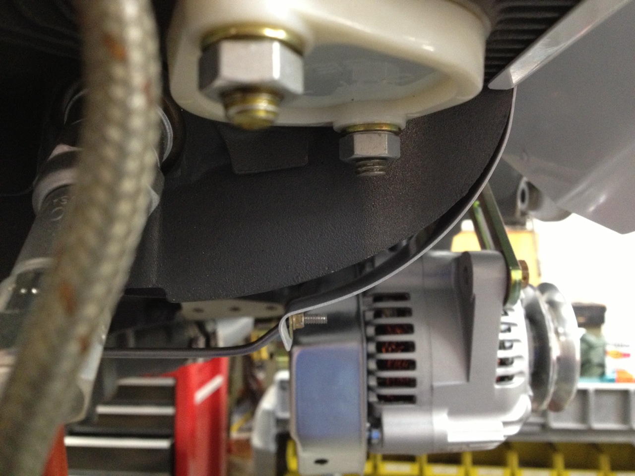

When I make the outboard tension rods to the plan specs, I get the gap you see in the attached picture between the curved portion of the fwd left air ramp and the cooling fins. Is this correct, or should a make a new tension rod to reduce the gap?
Also, I don't feel much resistance as I tighten the MS21042-06 lock nut on the 6-32 threaded end of the tension rod. Is this peculiar to me or have others found this? Any suggestions to keep this from backing off in flight?

Regarding the baffle rods, definitely do something else in addition to
the plans for them instead of just washers. It took 900+ hours, but
finally the stress was too great and the washer cracked through the
metal on those bent tabs of the baffle ramps. To fix the other one,
I got some 1/8" thick angle steel (remember one side of aluminum angle
has a rounded lip?), and cut it into 2 strips instead of being angle.
So I had 1/2" approx by 1.5 or 2" length. The rounded lip fit nicely
into the bend in that baffle, and I drilled a hole thru where the
baffle hole was. That way the entire piece of aluminum 1/8" backing
is pushing on that baffle ear, evening out the stress a bit.
Mine haven't backed off in flight, but they were snug.

There should be tension due to the nut being a lock but. It is possible that you have cut e threads on the rod too small.
In a perfect world, you would want it tighter against the cylinders, but I doubt you will see any measurable difference in cooling. I personally have started using .041" safety wire with a sleeve over it, which has proven to work well. I would make a mental note and see if that cylinder runs hot and then maybe make a new rod. The nut tension would be much more important to me. You could score the threads behind the nut to keep it from backing off, but make sure you have good threads.

I would recommend you do close the gap to make the most use of the cooling fins on the cylinder. I struggled with the rods as well and on the right side never could get a good fit and also not interfere with anything. In the end I just used a long piece of safety wire and it has worked great for over 600 hours and 7 years. Probably not so clean and I'm sure I just caused great disgust in someone, but whatever method you choose the baffle should fit tight. I vaguely remember the locknut not having as much tension as well, may just be due to the small size of the rod but I can't be certain.
Looks like you are getting close, have fun.

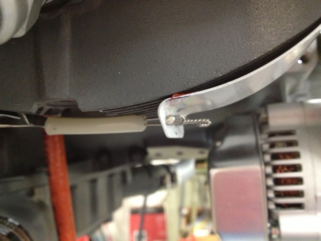

I'm not there yet so take this with a grain of salt: (maybe not salt
... bad for the heart) Wink
Seeing the replies using safety wire ..... I'll use the supplied rod to
go horizontally on the lip with the safety wire looped over the rod. An
anti-chafe tube over the safety wire should clean things up a bit.
Thanks for triggering a few brain cells!

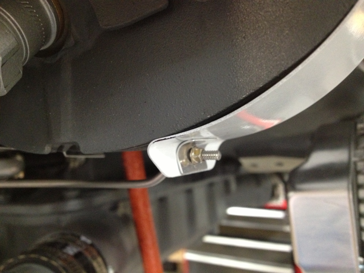

Y'all are doing it the hard way. I admit to making rods per plans, but will replace any that don't fit right with 6X32 all thread rod available at your favorite FAA/PMA dept of Lowes, Home Depot, etc.
The supplied rods are a real pain to run through a die to make the threads, especially due to small size.
The all thread has it done for you and you just cut to length, where it isn't critical because you can adjust nuts to fit.
You can then get 4 flat nuts for each rod, put one on each end inside the baffle, install rod and put one on each outside, with washers as desired. Then tighten the inner and outer nut against each other. I've done this and seen it done on certified planes with good results. You can enhance by placing sleeve of heat shrink over the rod to prevent any abrasion with rocker drainback tubes, as well as bending for clearance. If it makes you feel better you can use the self locking nuts on the outside. I do not like those tiny self locking nuts.

While your sleeve may protect the baffling, in general  I would advise against safety wire for this application, as I have seen it on many aircraft and it eventually cuts right through the baffling, leaving a broken hole.
Many production aircraft came with a pair of springs that hooked into the hole in the baffle, with a washer underneath to protect the aluminum, and then the other end of springs hooked together  in middle, under center cylinder(or between cylinders on 4 cyl engine). I haven't found anything easier to install, nor more durable than the all thread rod.

Okay... here's what I've come up with... a shortened tension rod and a custom washer made from j-channel. I don't think it's possible to get the gap any better. I'm still not happy with the lock nut resistance. I've got that question in to Vans.. and not happy that the nut isn't sitting flat, but that's been determined by Vans putting the hole too close to the bend.

.. just to report on the feedback from Joe at Vans:
He said that the curved portion of the air ramps should be pulled in as close to the fins as possible, but suggested a bead of red RTV near the flange to keep them from actually touching. If they touch, the fins will eventually wear through the baffle.
He offered that safety wire could be used instead of the rods, but that some kind of steel around the flange of the baffle would be necessary to keep the wire from cutting through the baffle at the hole.
Two nuts or loctite is what I need to use as the lock nuts don't seem to be "locking"

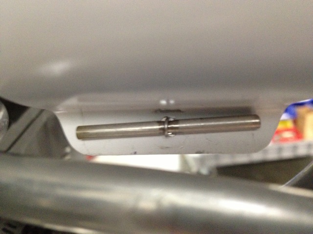

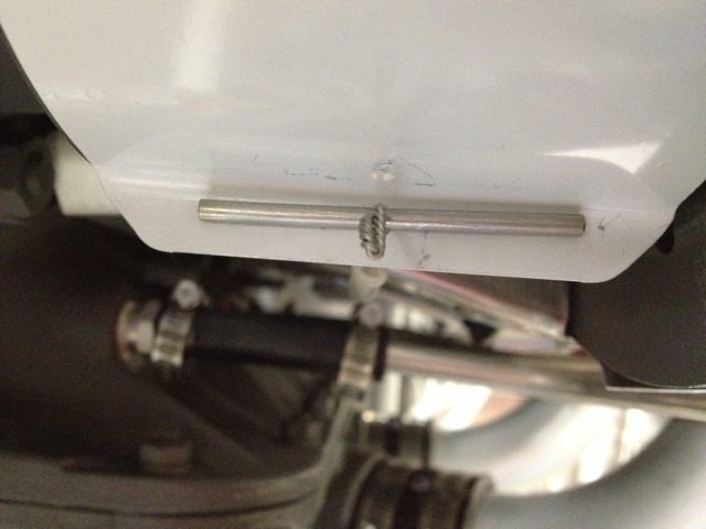

PostPosted: Mon Sep 30, 2013 4:11 pm    Post subject: Outboard Tension Rod Reply with quote
Okay... so here's what I finally wound up with. I feel like this will wear well. Time will tell.
Had I started with this approach I'd probably be finishing up the exhaust system by now... oh well.

PostPosted: Mon Sep 30, 2013 6:24 pm    Post subject: Outboard Tension Rod Reply with quote
Nice Jeff, is that aluminum rod or stainless?

jeff(at)westcottpress.com
PostPosted: Mon Sep 30, 2013 7:18 pm    Post subject: Outboard Tension Rod Reply with quote
That's the stainless rod that was furnished to make the tension rods with. You can see in one of the pictures that I ground a "dog bone" style groove in the center of the rods for the wire to nest in. That should keep the rods from working their way out.
