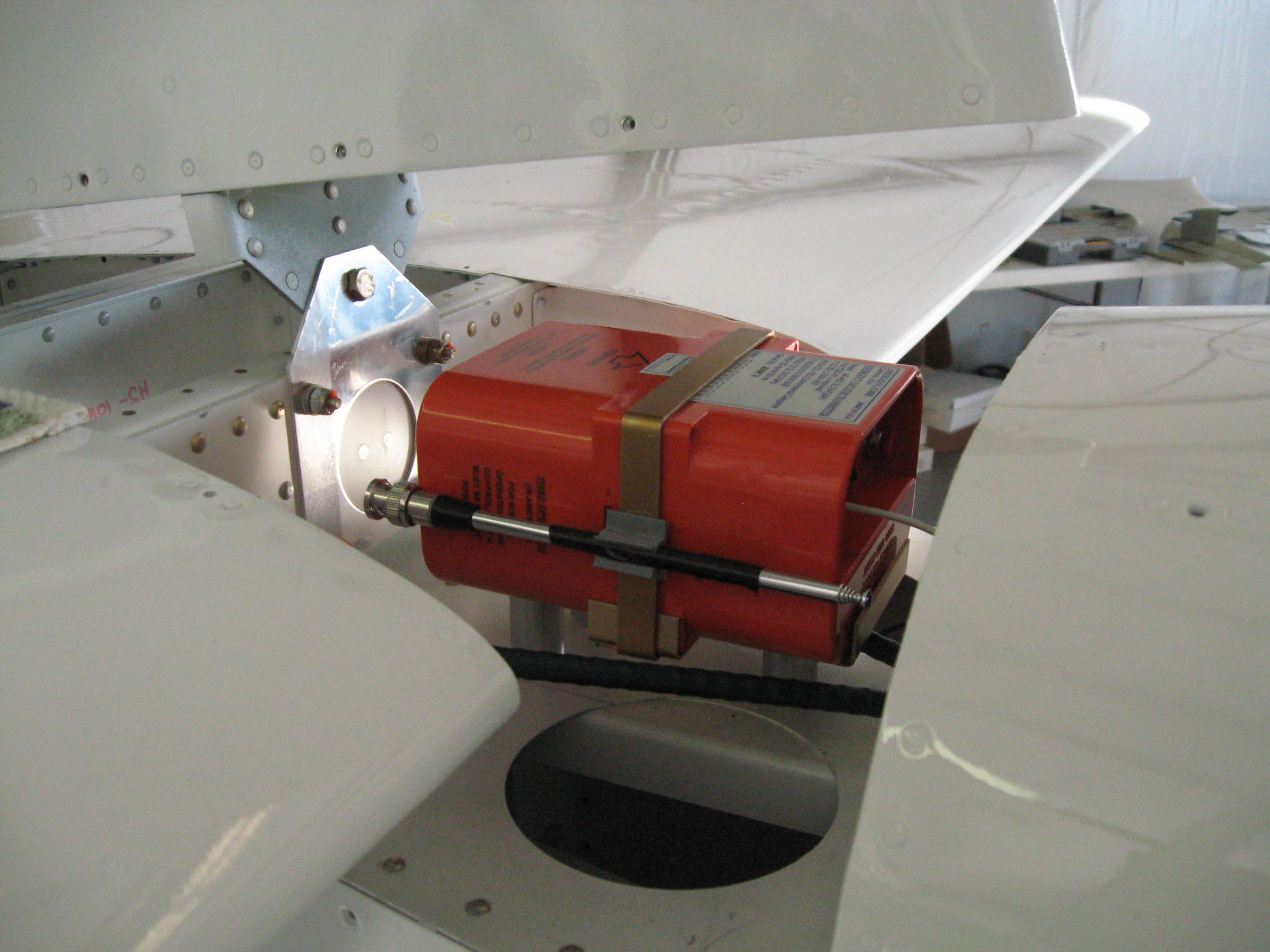

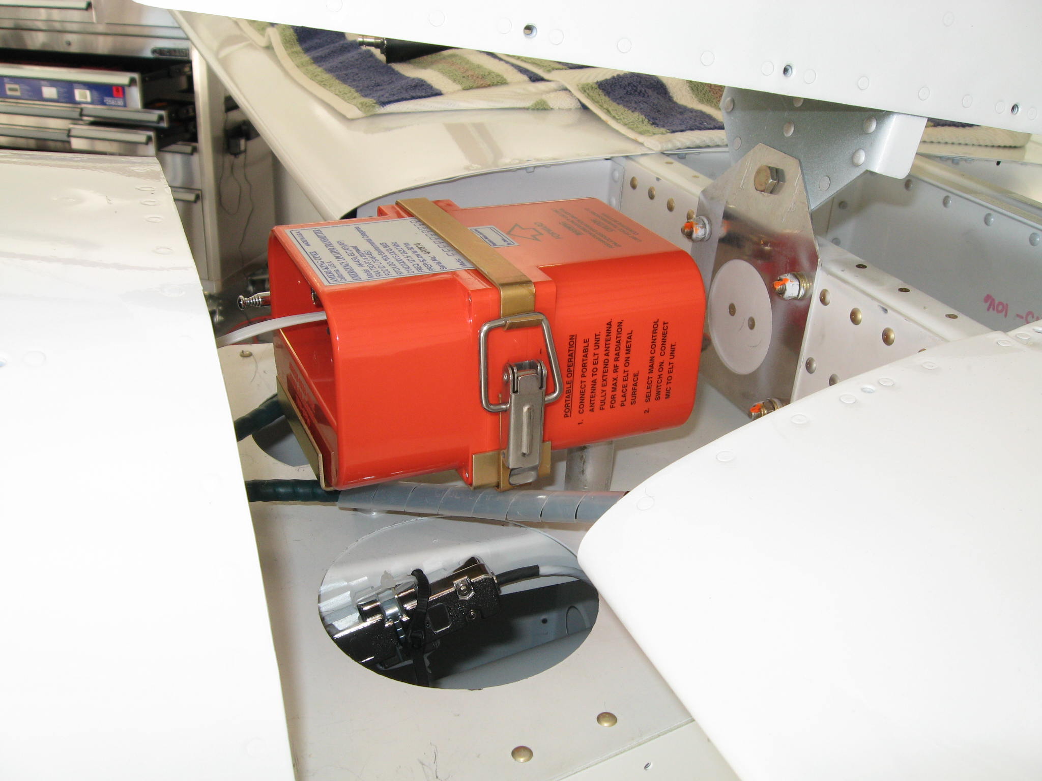

PostPosted: Mon Sep 09, 2013 8:42 am    Post subject: ACK E04 ELT MOUNTING Reply with quote
I built little aluminum standoffs and works great
Geoff Combs

Geoff,
That's the old 121.5. The new 406 E-04 is much longer and won't fit.
Michael

Interesting, just noticed the one in Geoff's picture is the old one.
Michael

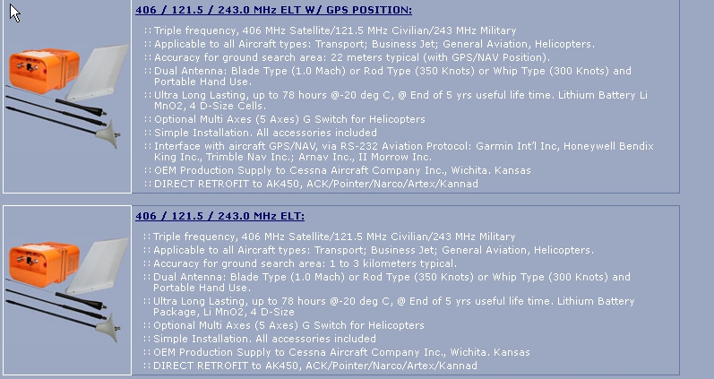

That is correct. These pictures were over 4 yrs ago. Below is the new 406
Ameriking that is a drop in
Replacement Pretty much. See Pictures
Geoff

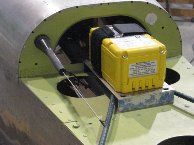

Not an ACK but here's my ELT mounting solution ......
[img]cid:part1.00020103.02090009(at)cfl.rr.com[/img]
It's an ACR/Artex ME406, but you can make the 'shelf' to fit just about anything. That's 3/4" alum channel with a piece of scrap alum riveted between and mounts the ELT. Those holes allow screw to go into nutplates to hold everything down.
I was waiting to talk to folks in a booth at Airventure last year and was standing next to the Artex booth. Filled out the entry for the ELT giveaway while I waited. Won the raffle! I hope to never use it though! Wink
