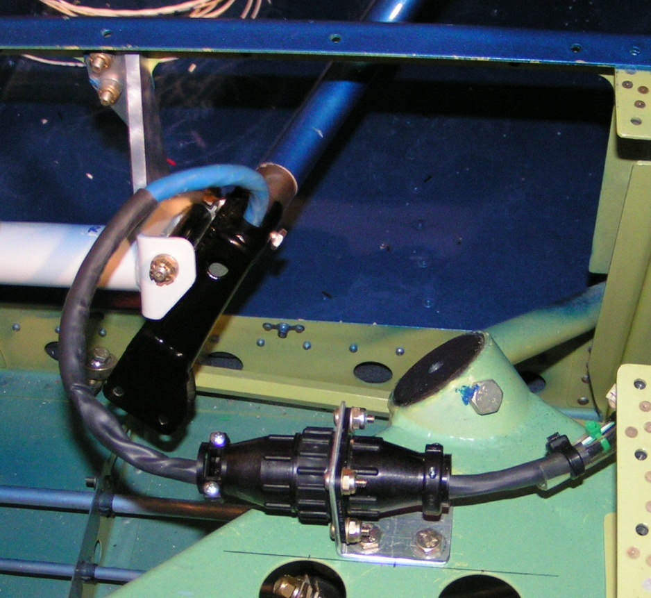

PostPosted: Sun Jul 21, 2013 4:55 am    Post subject: Re: Brain trust stick wiring poll Reply with quote
I ran mine inside also. There is no reason not to, and it looks better. You will have to drill a hole at the top of the stick where the vertical attaches to the main part of the stick. You don't need a large hole. I covered the wires with anti chafe skin and left enough slack at the bottom where it exits, to pull the grip up off the stick very easily if they need servicing. The downside is removing the stick requires disconnecting the wires. To aid in making this a bit easier, I used a barrier block with screw terminals. If you put a connector on the end of the wires, you will not be able to pull them all the way back out.
 Filesize:  141 KB
 Viewed:  19392 Time(s)
Bill

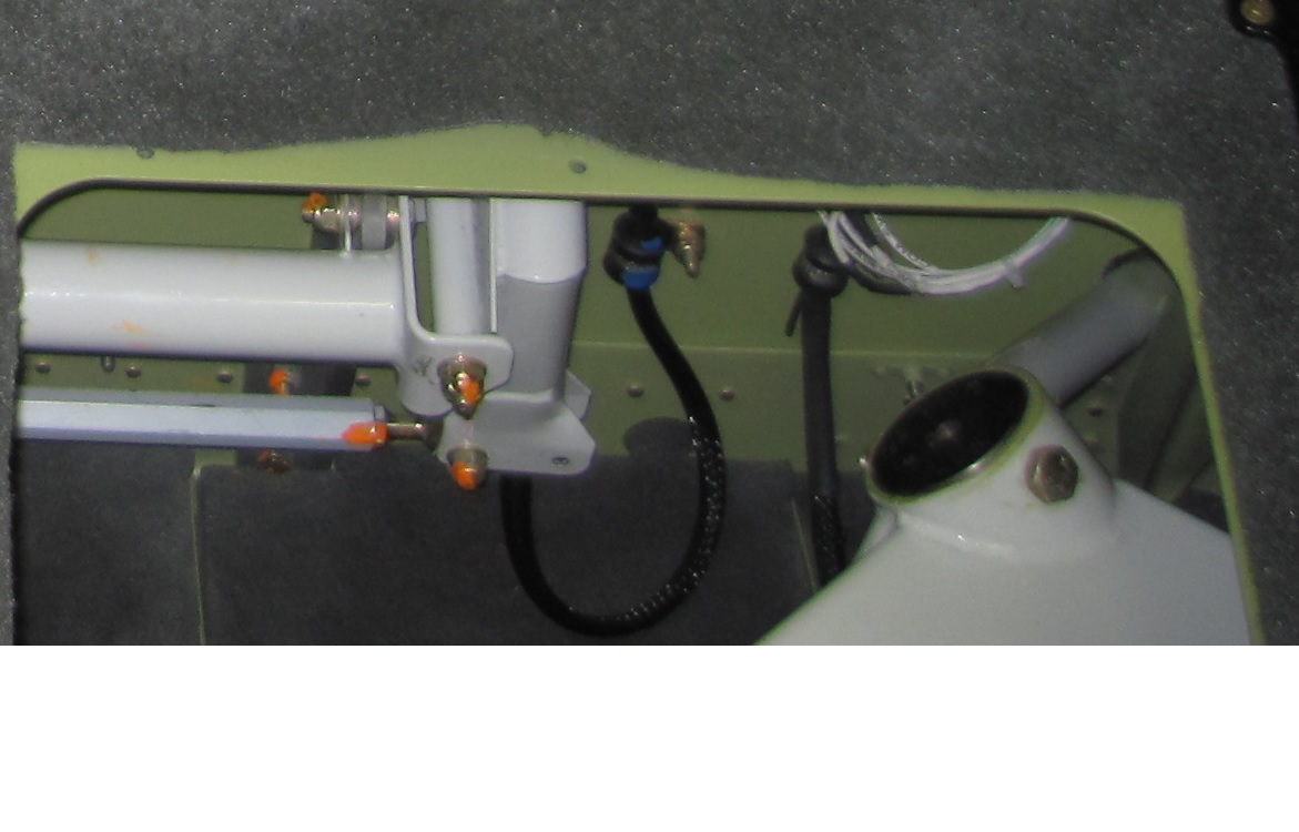

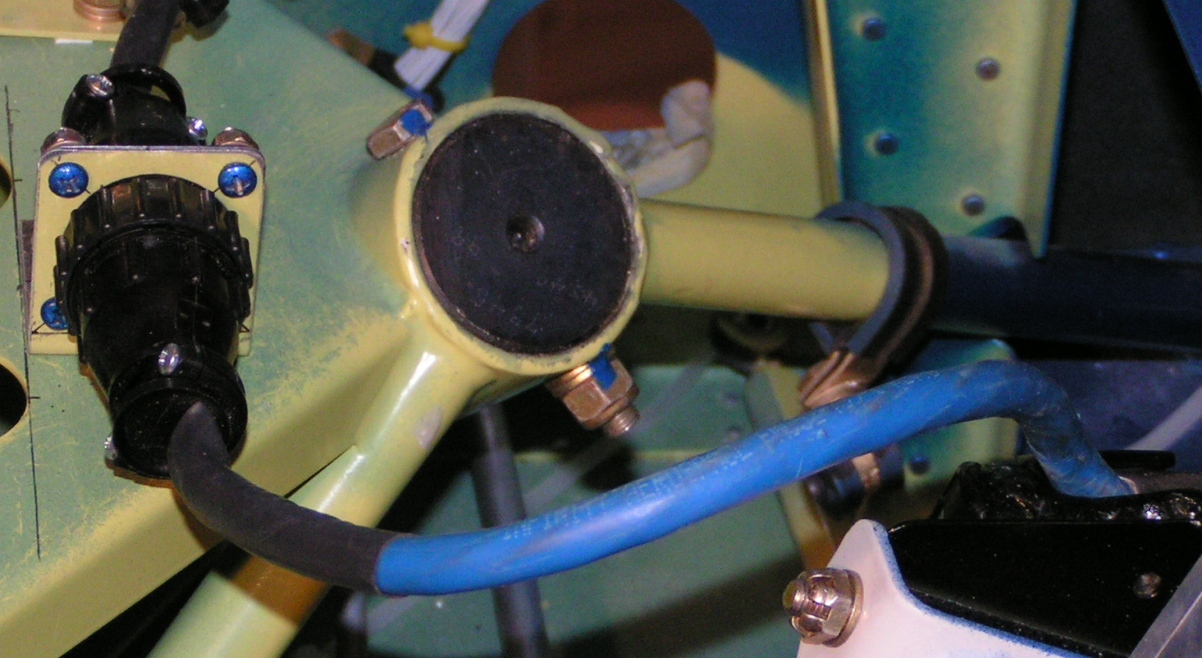

PostPosted: Sun Jul 21, 2013 1:47 pm    Post subject: Brain trust stick wiring poll Reply with quote
Here is a solution for running inside the stick. We welded a doubler on the
stick receiver since we slotted it. This allows complete removal of the
stick with the wiring/CPC connector. Infinity grips used.
-Chris Lucas
