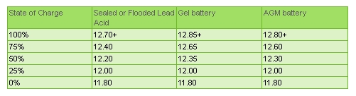

That's not a 'bad' value. There is a period of time
after charger disconnect until the battery terminal
voltage falls to its nominal resting value. There
are small variations between lead-acid technologies
but they'll generally fall into this range of values.
[img]cid:.0[/img]
These values are accurate only after a considerable 'resting
interval' for removal of either a charger or a load . . .
a 6-hour rest before measurement is probably reasonable.

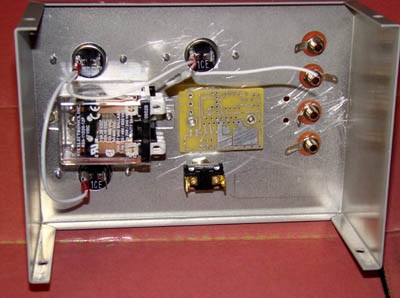

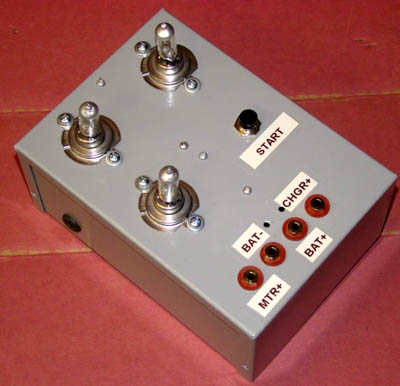

Made a few drill chips this afternoon and got all the
hardware mounted on the proof of concept Bat Cap Checker.
[img]cid:.0[/img]
[img]cid:.1[/img]
All the holes have been plugged with screws. It's
time to stuff the board and wire it up.
This version is configured to run a battery down using
the chosen load . . . in this case 3x55w lamps.
When the test terminates, the lights will go out,
the relay will drop and connect a charger to the
battery for replenishment. Touching meter leads
to BAT- and MTR+ will yield a voltage reading
between 0 and 5 volts. 5 volts = 5 hours of
endurance.

[img]cid:.0[/img]

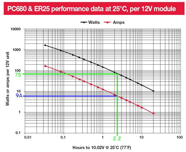

Hmmmm . . . according to data right from the horse's
mouth, a 75 watt load on a new PC680 should take
it down to 10.00 volts in about 2.2 hours. This corresponds
to a current of about 9A.
[img]cid:.0[/img]
I'm pretty sure that Watts and Amps are CONSTANT values applied
by a 'smart' load . . . which resistors and lamps can only approximate.
Nonetheless, the fact that you were still above 12.4 volts after two hours
raises some questions. At first blush it appears your battery
is in REALLY good shape.

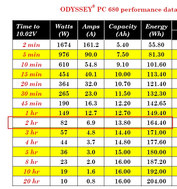

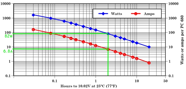

Here's an excerpt on PC680 data from another Hawker-Enersys
document . . .
[img]cid:7.1.0.9.0.20130715121715.020f01f8(at)aeroelectric.com.0[/img]
. . . and the companion plot
[img]cid:7.1.0.9.0.20130715121715.020f01f8(at)aeroelectric.com.1[/img]
This plot is consistent with tabular data and with your
test results. I must conclude that the earlier posting was excerpted
from erroneous data.
The fact remains that your battery seems to be in good shape . . .
which still leaves us with questions about the observed self-discharge
rate.
