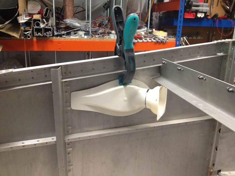

The front seats fresh air vents which came in this kit are like this
with the female part where the eye-ball valve will be mounted.
But if I leave it like it is, this female part positon is not paralel with the instrument panel surface.
Is this the way you installed it?
Or did you cut that part and installed it flush with the panel surface?
Carlos

Most folks will install an eyeball vent, such as those that Stein sells. Then run a short piece of scat between the naca vent to the eyeball vent.

I have mine installed at that angle and find that they work really well that way. Each one can pretty much be pointed anywhere in the cockpit when mounted at the prescribed angle. Now, if you are going to have a custom glass or carbon fiber panel with the vent actually mounted in the panel, then you would want to modify as Bob suggests. I bought the upgraded aluminum eyeball vents from Van's. http://www.vansaircraft.com/cgi-bin/store.cgi?ident=1368273286-484-93&browse=heatvent&product=sv-6 They are very similar to the ones Stein sells. These are probably the most efficient air vents I have ever seen on a light airplane. They adjust easily and are capable of providing way more fresh air than you usually need, The aluminum vents from Vans do not leak in rain, either.
I think they work really well when mounted as per the instructions. I don't have any good closeup photos, but here is one in my old "pre-GRT" panel.

I agree with Dave. I also just used the stock black nylon vents as I
figured I'd rather spend the extra $300 on avgas. They work well. One day
I'll probably breakdown and spring for the nice aluminum ones from Van's.

Mine are not supported below the panel and they are rock solid. I believe we used proseal to mount the vent scoop to the fuselage wall, but it has been so long now that I cannot say that for sure. Sorry about the photo. I did not attach it properly, but if you log on to the Matronics site you can see it on my post.

I used the large eyeball vents from Stein attached directly to NACA vent using proseal for both like David. Stock panel. Works great.

I'm not sure which David you are referring to but mine are the Steinair vents mounted to the stock RV-10 kit Naca's with the square flange.

Carlos, I did something a bit different.
I can see from David Maib's photo that he has a Stein panel blank as
well as Steins eyeball vent. I used the same panel blank and vent but
instead of mounting it below the panel, I put the vent on the panel and
ran a piece of SCAT (I actually used CEET for the color and so that the
wire is covered, won't rust and it has less internal friction to air
flow). Take a look here:
http://www.mykitlog.com/users/display_log.php?user=MauleDriver&project=224&category=5253&log=66090&row=6
It turns out that you can do a minimum radius 360 turn with the SCAT
quite nicely. I just added a pic showing it finished:
http://www.mykitlog.com/users/display_log.php?user=MauleDriver&project=224&category=5253&log=170694&row=1
The SCAT (or CEET) is slightly visible underneath the panel but is
completely non-obtrusive. I think the vent looks best mounted in the
panel. Makes a nice water trap if that's a problem (I guess it isn't
because I've never heard anyone complain about it)

I used the Stein vents mounted in a hole in a piece of scrap aluminum, which in turn was mounted directly to the Van's duct with some screws/nuts.
I did put a piece of nylon screen in there to keep out bugs.
I mounted the Van's duct late in the game, and as I had no easy way to clamp it, I used a couple of flush pull rivets (fore and aft) to hold it while the pro-seal set. I left the rivets in.
Works fine, air can be directed anywhere, lots of it once you're moving.
Bill "having just been reminded that it's bird nesting season... do they
always build on cylinders 1-3-5" Watson

PostPosted: Thu May 16, 2013 2:10 am    Post subject: Fresh Air Vents Reply with quote
Thanks David.
There are a few things I'd do on my next plane too... but I've told
everyone I know that I only have one in me. It's been the best project
ever, but I'm thinking it best not to return to the scene of the crime.
