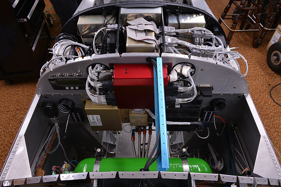

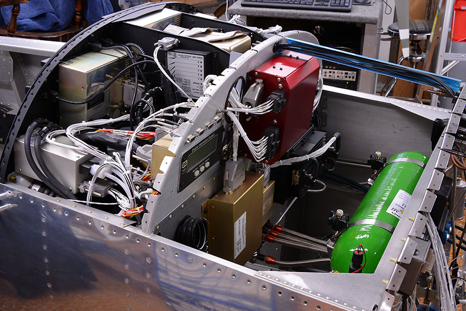

I couldn't agree more. I have a VP-200 system in the RV-8 and in the RV-6 and I couldn't imagine not flying with one. I've got well over 300 hours on the two systems without a single issue. The electrical automation that the VP-200 brings to the cockpit is outstanding. The simplification of wiring can't be understated. I am also very disappointed that Vertical Power hasn't stayed focused on what they are really good at - electronically controlled aircraft electrical systems. Hopefully VP will come out with something more akin to the 200 in the future.
