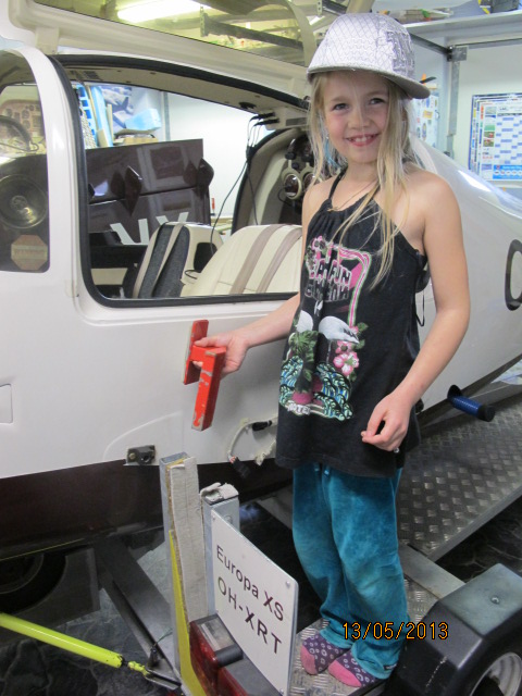

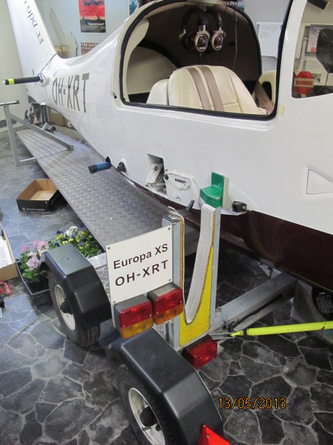

PostPosted: Mon May 13, 2013 5:56 am    Post subject: Europa monowheel trailer, fuselage support Reply with quote
Hi Phil
I took couple of new photos and they are attached.
You can find at least four Europa mono trailer
mods, which all are important (at least I think
so):
1) Fuselage support "pads". a Fuselage side of
them is softened. They are not welded - they are
removable as my daughter shows. That is a must to
make a fuselage moveable. The wing carriers are
not very stable by nature. They are normally fixed
by pip-pins only. I added locking bolts also and
now they are like welded. An extra advantage:
fuselage must be very straight before dropping
those pads to the wing carriers. These pads reduce
some heavy sideway loads from the gear /main wheel
swing. Green and red colour are just for fun.

This is a very timely thread for me as I'm just in
the process of doing a few mods on a mono trailer.
I'd be very grateful if some of the previous
posters could post or send some photos of their
solutions. The only other one I know of is
Raimo's idea which has some small pads welded to
the wing carriers that hold the fuselage stable.
There is a photo of that on this forum if you
search hard enough.
Phil
