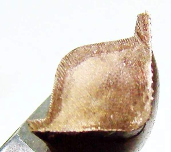

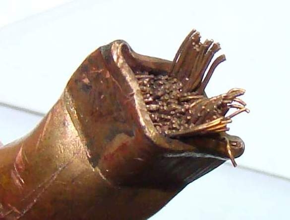

John sent me the carcass and we've had a chance to
peek inside the failure . . .
[img]cid:7.1.0.9.0.20130417192013.04c572e0(at)aeroelectric.com.0[/img]
95% of the strands failed right outside the crimp . . . a
telltale for insufficient insulation support like that offered by
PIDG style terminals.
A cross-section of the wire grip . . .
[img]cid:7.1.0.9.0.20130417192013.04c572e0(at)aeroelectric.com.1[/img]
. . . showed good crush . . . no voids. I'm pretty sure that
a piece of that extra stiff, two-walled heat-shrink over this assembly
would have produced a better story.
