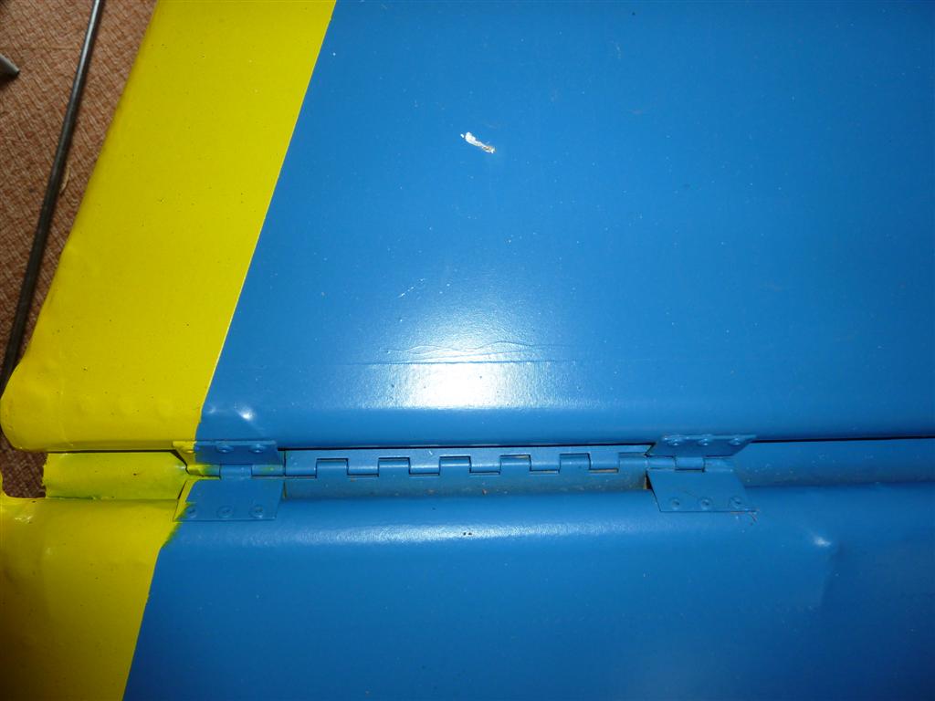

Here is a Picture of the X-Hinge I am using on my Firestar II. I do not know if these can be bought but they are very easy to make. It takes twice as much hinge to make these. Some people think less is better, but I think I need to make things as good as I can if my life is depending on it. This is by far stronger, and maybe even over-kill but I will bet this set-up is less likely to fail.
Best Regards Joe

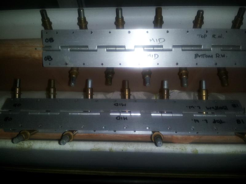

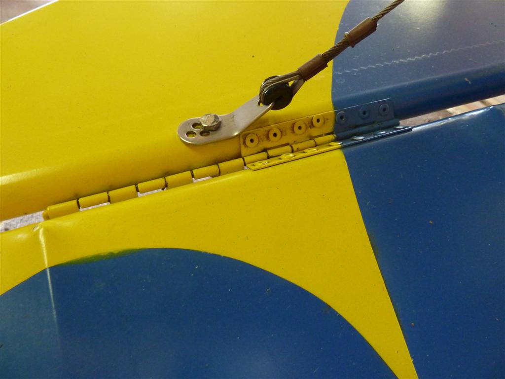

You can also split them this way:
 Filesize:  59.49 KB
 Viewed:  9071 Time(s)
 Filesize:  63.81 KB
