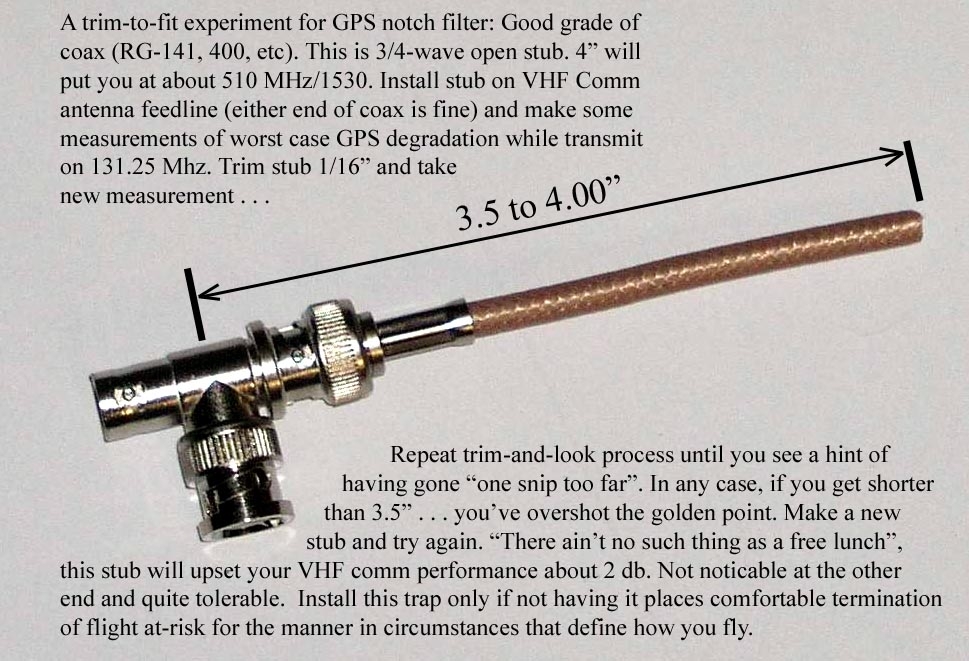

I went to the workbench and fiddled with a 'po man's
notch filter.
[img]cid:.0[/img]
While you're hammering on the airplane this winter, you might
conduct the experiment above. Let us know what your final dimension
is. Yes, the 'active dimension' includes conductors inside the
coax T-connector. You'll want to do some look-see at the 13th
harmonics too . . . near and either side of 121.25 Mhz. In fact,
do the initial experiments at the 13th harmonic values . . . odd
harmonics from transmitters tend to be much stronger than
even ones.

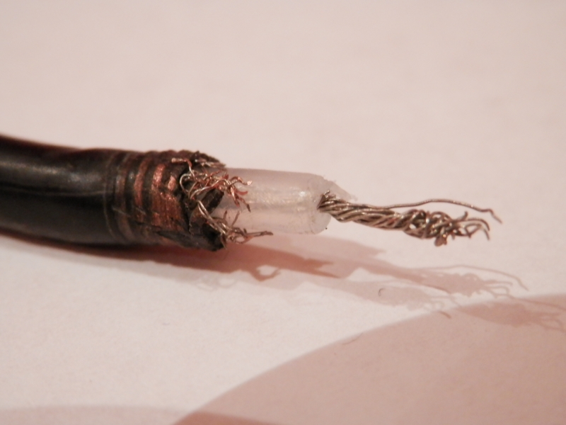

Went to my hangar last week, started to remove radio equipment. Took the coax cable and brought it to work to show to the "experts", Electronic Dept.
One BNC connector is a twist (screw-in) type, I find that cheap to use on aircraft (personal opinion). Anyway, we started un-twisting the connector and wow, no crimp with the middle pin, is that normal ? and shield was almost gone !! see picture.
Coax is (was) RG58C/U and will be replaced by RG142.
It was time to replace that connector before it
flew for the first time!

I've just learned that Twist Type BNC connectors should be use with solid center conductor only....
JP
PostPosted: Fri Jan 18, 2013 9:56 am    Post subject: vhf transponder interference Reply with quote
At 11:26 AM 1/18/2013, you wrote:
--> AeroElectric-List message posted by: "jappie" <jappie(at)videotron.ca>
ha !
I would argue further that twist on connectors should
not be used for any connector. Well, with one exception.

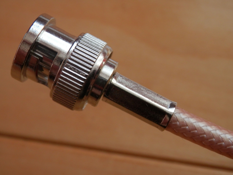

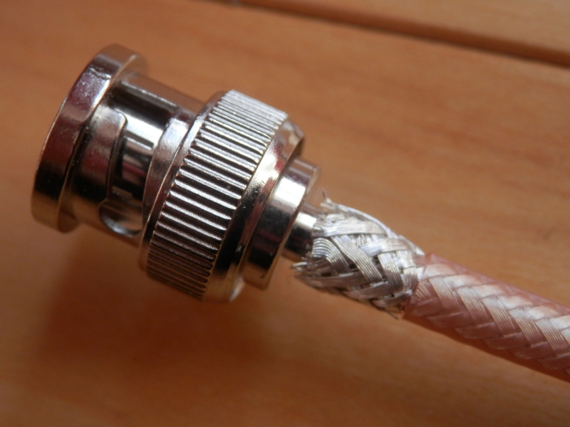

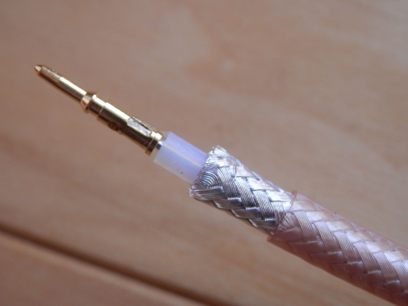

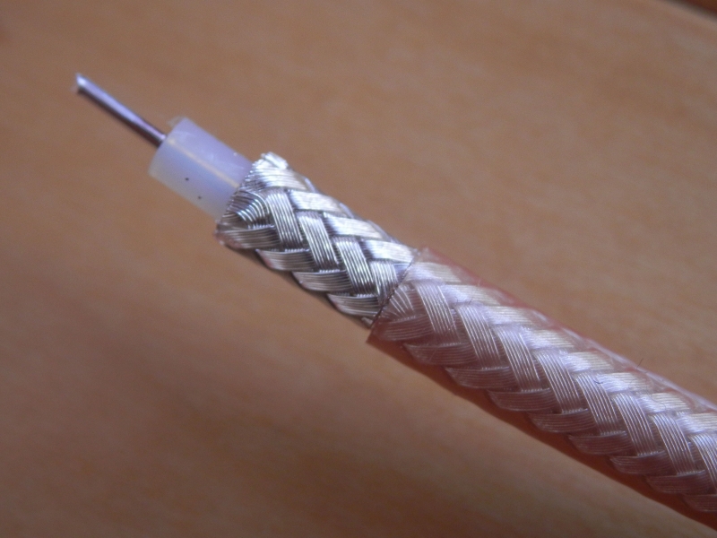

Here is my new RG-142 cable.
pictures are in the wrong order
JP

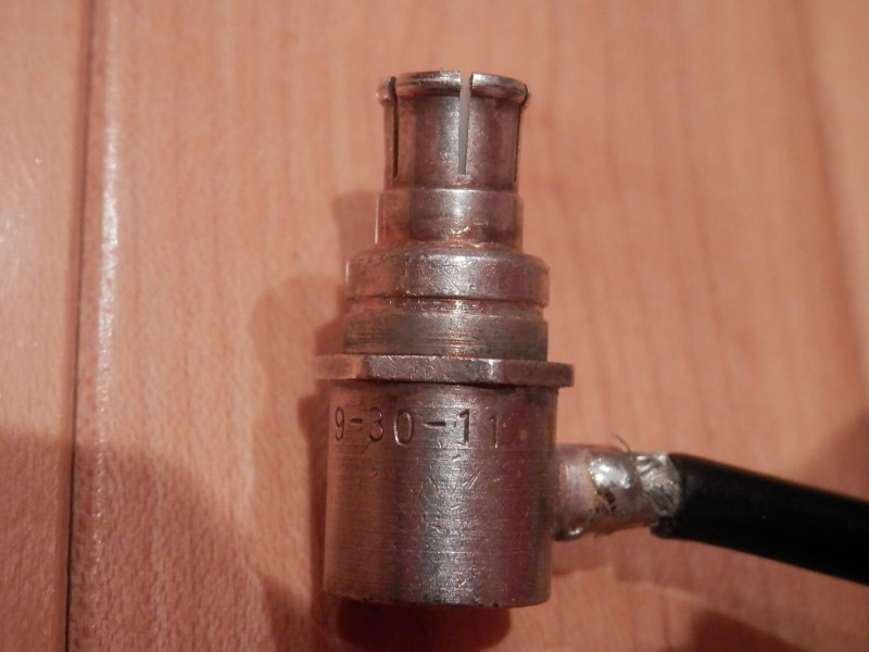

After making a new comm cable , I decided to replace the x-ponder cable also, GTX-320, so I removed the old one and found my BNC connector (coax panel mount) to be a TED 9-30-11 ( look at the picture) but can't find anything on 9-30-11, instead everything I find is 9-30-10....
JP

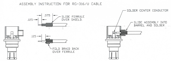

what is the importance of the Impedance bushing inside this connector TED 9-30-10 ?
I've been told to use use it only with a certain type of cable ...
My old one had none, maybe one of the many reasons I have interference...
JP

I wrote to TED Mfg to ask for their published instructions
on assembly of this connector. An excerpt from their reply
is shown below:
[img]cid:7.1.0.9.0.20130321120308.048a19f0(at)aeroelectric.com.0[/img]
I'll publish the entire document in the Manufacturer's data
folder of aeroelectric.com later today.
The bushing you asked about is used for smaller coaxes.
The .2" diameter coaxes like 58, 400, 142, etc do not
require it.

I did my soldering last weekend with RG-142 but I installed the impedance bushing not knowing better, anyhow, I don't think it will be harmfull.
JP
