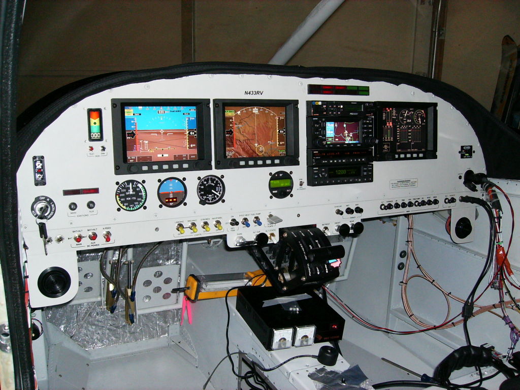

Regarding the cabin heat system, I have a couple of questions:
- Where did you put the control knobs of the cables which control the rear and front cabin heat?
Is it good to put the front heat control knob in the instrument panel, and the rear heat control knob behind the front seats, thus leaving this control (only) reachable by the rear passengers?
- Those of you who used the modified “T” (VA175), in order to have left / right control, where did you put the control knob for this feature?
Cheers

Both heat control knobs need to be accessible to the pilot. I find that 90% of the time when I have heat on I just have the rear on. I find no real need for a left/right control – but to each his/her own.
I have the oil cooler air butterfly valve (blank knob) control on the pilot only side of the panel, next to the alternate engine air (red knob) control. The heat knobs are next to each other on the co-pilot side (but reachable from the pilot seat). That way the co-pilot will not mistakenly touch the oil cooler or alt air controls. All controls are on the panel apron. When you pick the spots, make sure you do not create interference for full stick travel.
Carl

I put these controls and the air filter bypass on a plate that attached to the rear of the panel with screws from the front. The knobs fit through an oval hole cut in the panel. Otherwise the controls will have to be removed if you want to take the panel out. Makes service much easier.

Jesse
Will you please send me a picture of your setup.
Carlos

photo attached...
Cheers,
Jay
