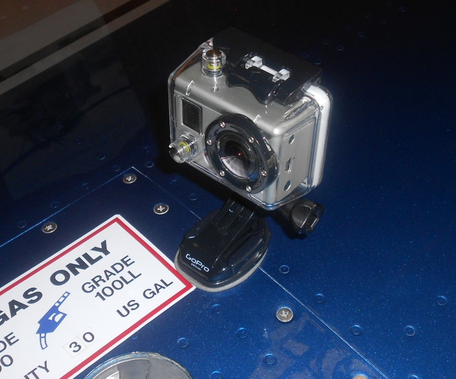

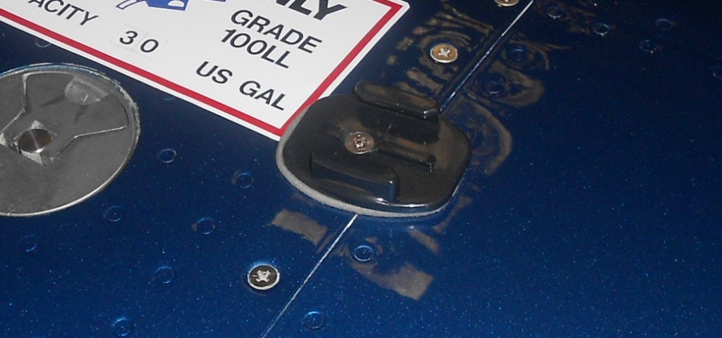

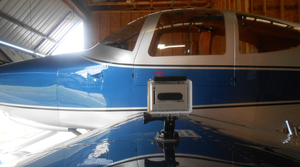

I found this scheme on Van's Air Force I think.
The mount is the standard go pro flat adhesive base but with backing still on adhesive. The adhesive pad acts as a paint protector/cushion. A hole is drilled in the mount and countersunk. I have used on the top and the bottom of the wing using a longer fuel tank screw to hold it on. At cruise and in the pattern no issues and pretty stable - sometimes I can tell the automatic stabilization is kicking in on the camera or rather not keeping up with a slight vibe.
-Chris Lucas
