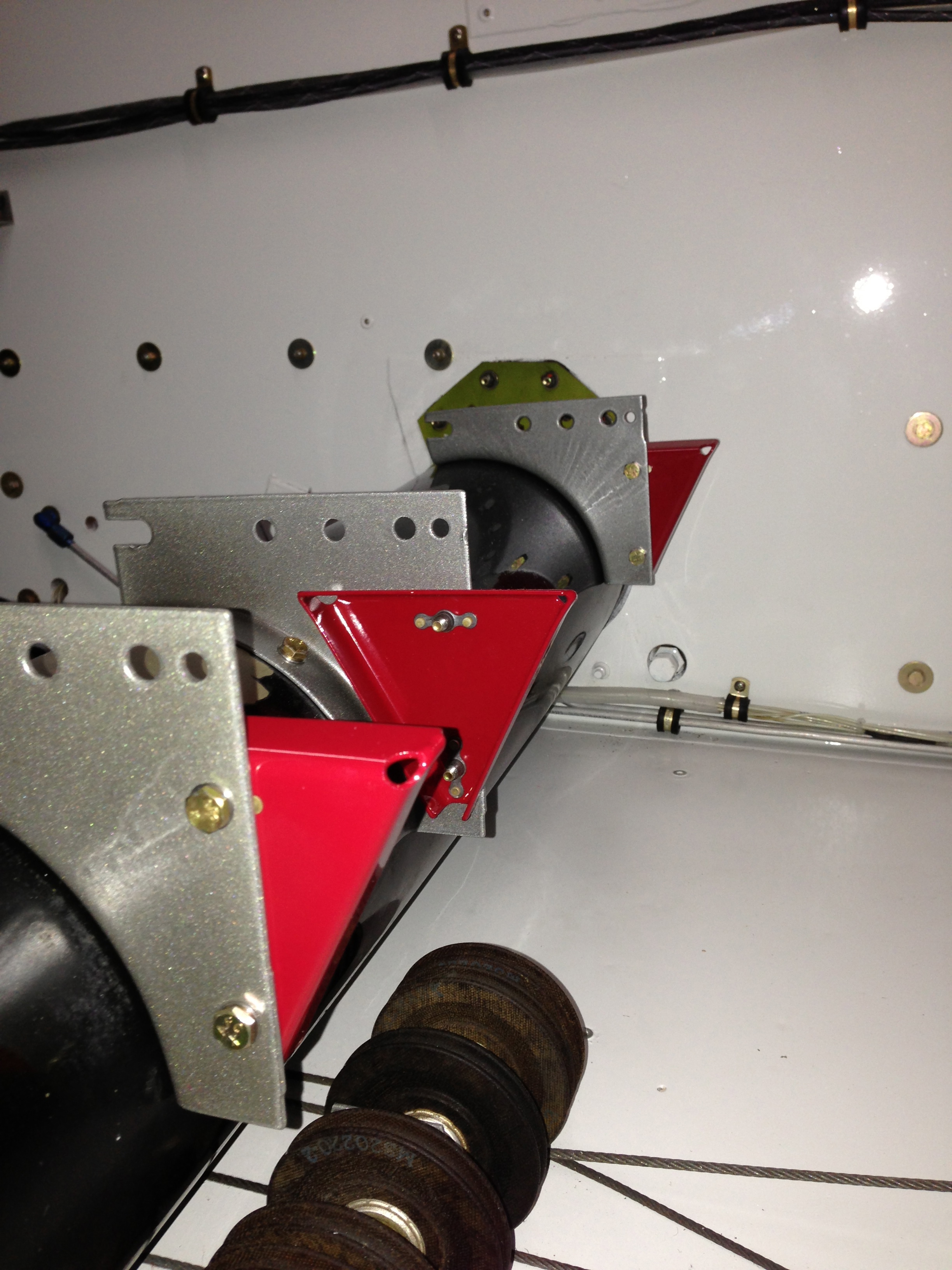

Gary .... I guess that's a pic from an AA-5 ..... but it would be nice to have a description for us that are -5 ignorant!!

Oh, I see now. That was to go to me. Ooooppps.
Ok, it's the rear console cover for my Tiger. It's made of fiberglass; 4 layers of glass with 1/4 foam core on top.

Hi Linn:
It looks like an OooPsy cover.  It is covering the the cables that goes down the centerline of the plane to the tail.  It is so clumsby people don't step on them.  OooPsy!
But then again the floor sure looks nice - Painted Maybe?  So it could be just a paint shield so the cables and the color coding on them do not get obliterated.  It does look like the spar has a paper cover?    But, if the floor is painted and the cables are not - How come the small area between the OooPsy cover and the spar - Where the cables show - The cables are not painted?  TRICK PHOTOGRAPHY?  And why not paint the spar?  UNLESS?  The spar is painted a different color!  Gary, are you getting into Fung Shway and home decorating?
More energy flow through the centerline of the plane could equate to more forward speed.

Gary:
That sure looks gorgeous.  Will the owner appreciate it?
And have you been checked for OCD?
Smile

It's CDO. It needs to be in alphabetical order.

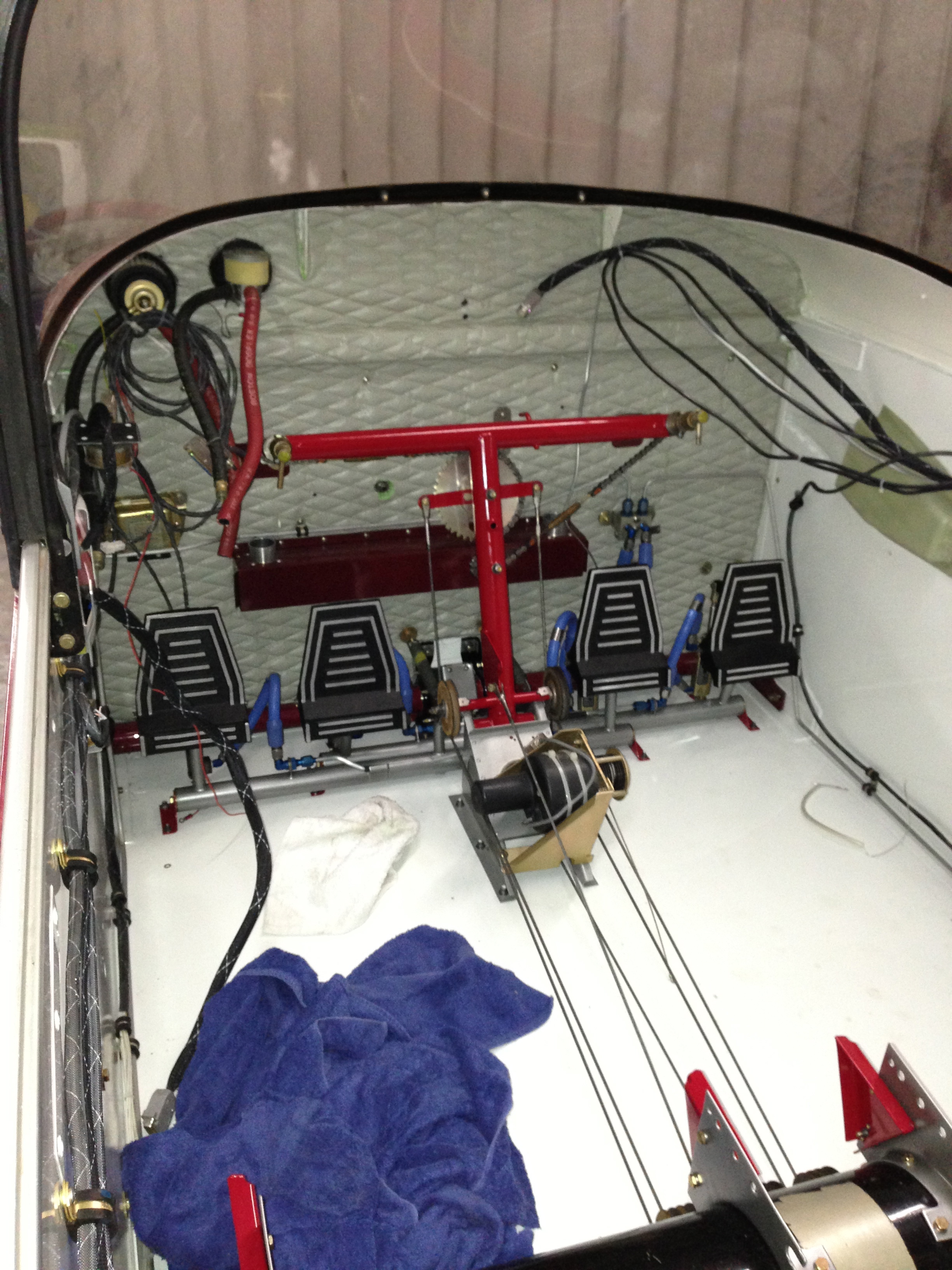

I don't know if everyone noticed but there is a modification to the canister vacuum filter installation in the first picture. It is probably one of the best things you can do for yourself or your mechanic (it's described on the AuCountry website). Now if Gary could come up with something for the garter vacuum filter I'd be a happy camper.

Roger:
I can't see it... Does it have a Wingnut?  Indicating removable from the inside?
I don't know where I first heard of that - Gary if it was you, THANKS!  I did that after my first Annual 14 years ago.  GREAT IDEA!
Now - If you want the Mod for the Garter Filter... EASY.
All you have to do in put a spacer on the INSIDE between the fixture and the firewall.  I did this with a large brass nut - I just happen to have.  All it has to do is give you room to slide on and off the filter.  The only issue is you have to remove ALL the hoses so the fixture is spaced away from the firewall.  NOW - Thinking back.  You maybe able to do the spacing using a piece of heavy wall PVC (Sked 40) and making a 'C' shape just to snap over feed through part of the fixture.  About 3/8" thick.
Two other tricks to get things to fit:
1 - Remove the Sound Proofing around the fixture - It helps a little, or
2 - Flatten it down by installing a thin sheet of aluminum - It also helps a little.
I went with the EASY method.
Barry

Yep, the wingnut is there. I had to click on the pic and zoom-in to see it. Thanks for the ideas on the other filter.

When I put the firewall blanket on, I made a cutout for the Vacuum filters. Then, I glued the patch back into the hole. It helps some. Just not a lot.

hadn't thought of that. good idea.

Hi Gary
What product is that firewall blanket, it almost looks original.

It is the original type. I got it at WagAero.
