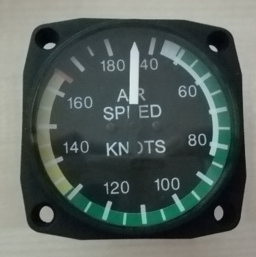

I have a Skyview too and bought the 2 1/4 ASI from Europa (because it comes with the white, green & yellow arcs & Vne red line already marked); and the 2 1/4 Winter 0-5,000 Alti from Transair http://www.transair.co.uk/sp+Winter-Instruments-Altimeters-Winter-Altimeter-Single-Needle-Millibar-Scale+1018
They will both fit neatly above and to the right of the 7" Skyview.
I know some recommend the 1 1/2 turn ASI to give greater resolution at low airspeeds, but the Skyview is my PFD and if that failed in flight I'd be looking out below about 60 kt.
Likewise, the Alti I bought only reads to 5,000 ft on one turn, but if I can't figure in VMC whether I'm at, say, 2,000 or 7,000 ft, then I have no business in the top left hand corner of any aircraft... Wink
