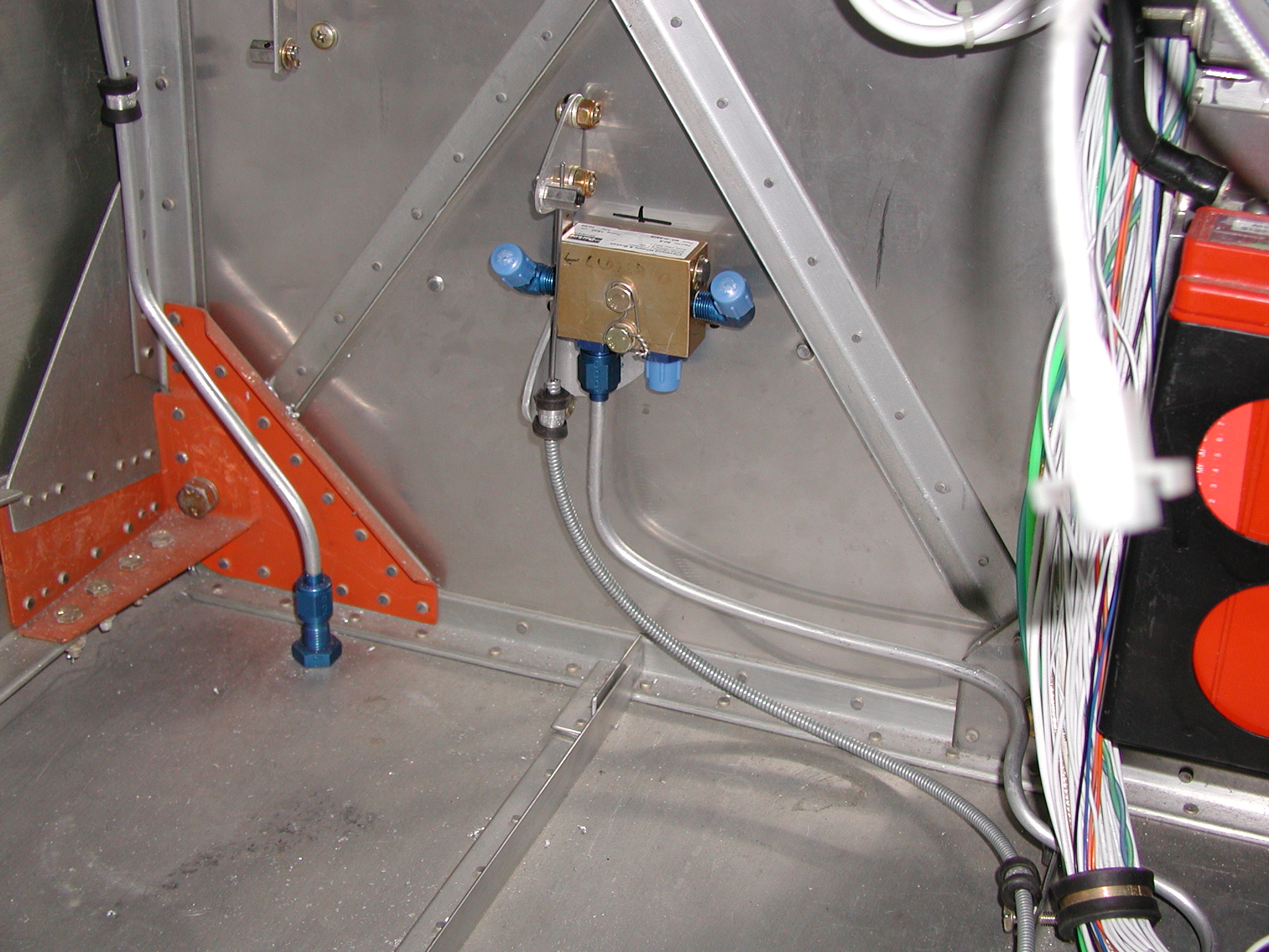

recapen(at)earthlink.net
PostPosted: Tue Feb 26, 2013 12:35 pm    Post subject: Parking brake check valve Reply with quote
Jim,
Here's mine.....
Hope this helps.....
Ralph
 Filesize:  683.18 KB
 Viewed:  6130 Time(s)
