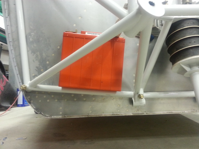

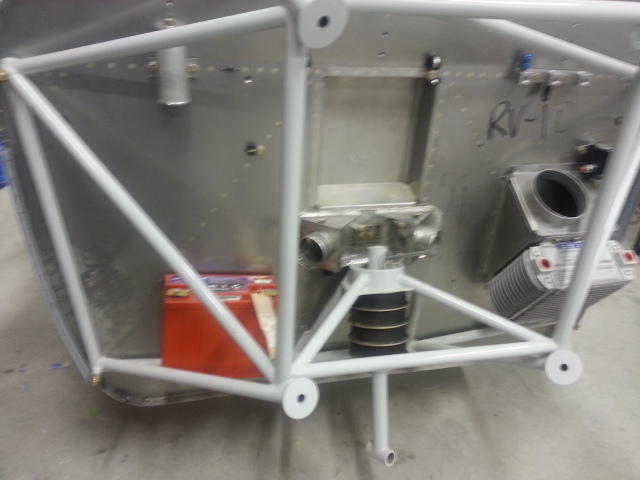

Looking to mount second battery on firewall with aluminum tray from Hawker. Thinking about letting bottom of tray/battery rest on engine mount with baffle material on mount. Anyone foresee a problem or better location?

I'd never do it.

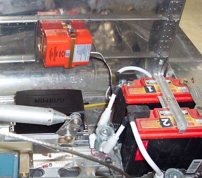

I'm with Tim. Keep it of the engine mount at a minimum.
Here is my dual battery set up. I have a 3rd (smaller) battery that exclusively supports my D100 in case of a total electrical failure.
Robin

Dave, just a comment about letting the battery box rest on the engine mount. Consider that over time dirt and oil will work its way into the interface between the box and the engine mount. This slurry under pressure does a good job of sanding away at your engine mount. This situation is a bit different than using cushion clamps to hold something to the engine mount because the firewall and engine mount flex differently so there is more potential for relative movement. I would favor just mounting the box to the firewall, maybe with a backing plate to help reinforce. I have no first hand experience with mounting a battery on the firewall, but the practice is common in two seat RV's. Consider heat, and vibration as cons, cable length and weight as pros. No comment from me on W&B as I have no idea what else is being installed and where. It is worth while to run a W&B calc based on the two locations and see what difference it will make.
