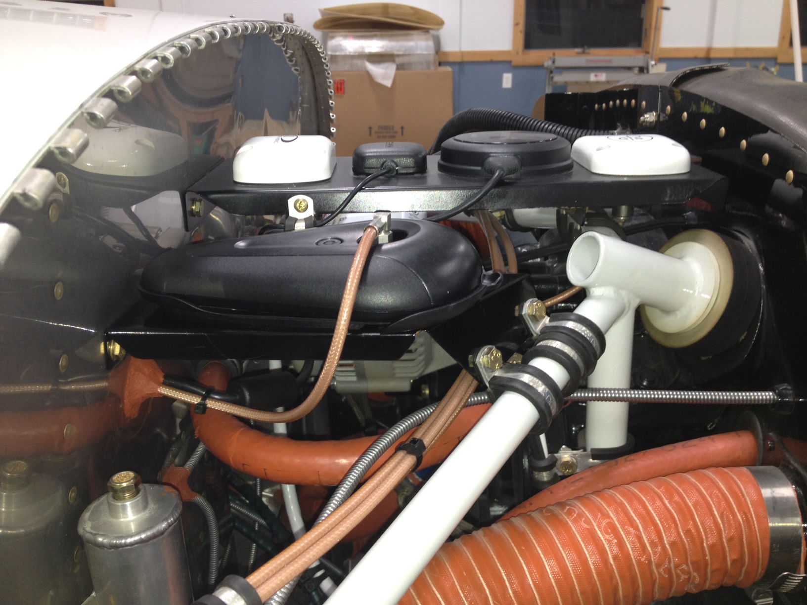

Firewall forward Works great!!!
I have 3 mounted an a Vans RV12 mount.
Great coverage...

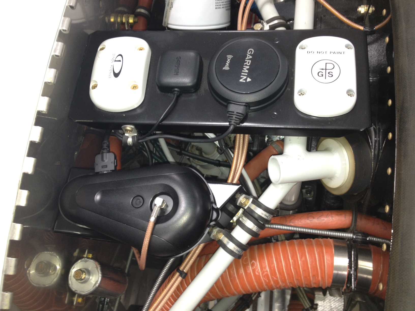

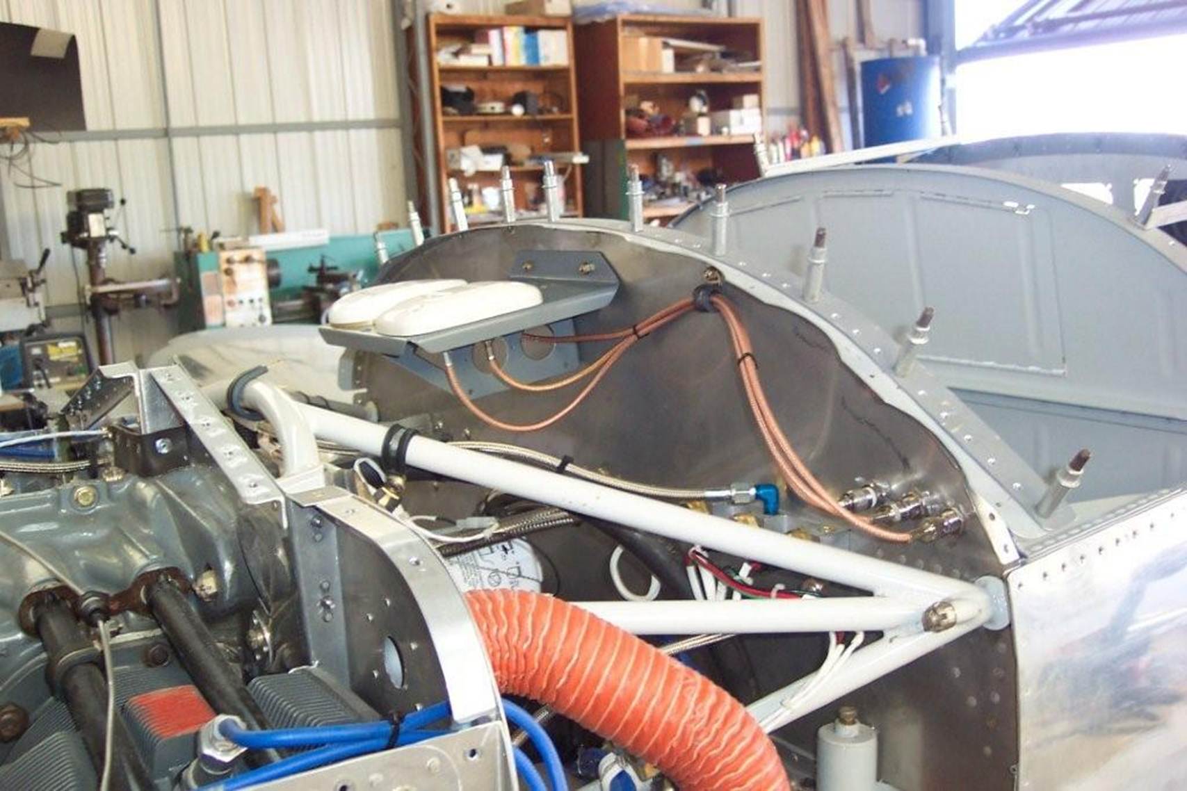

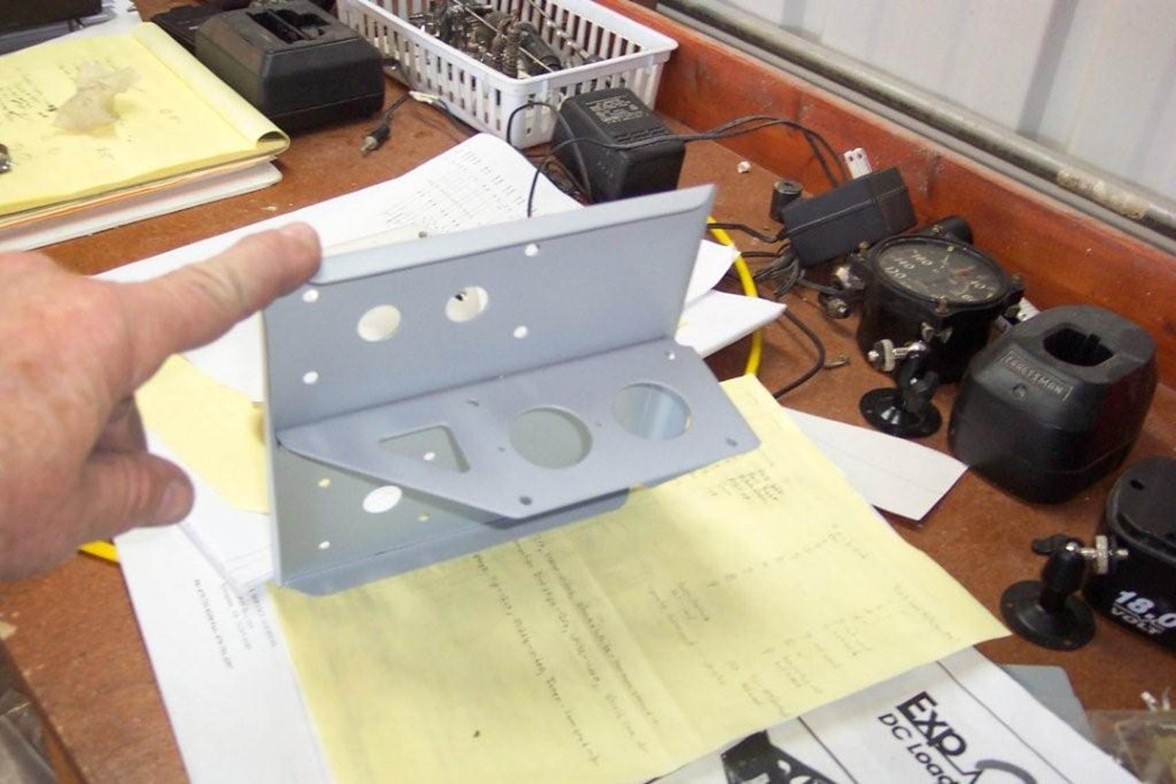

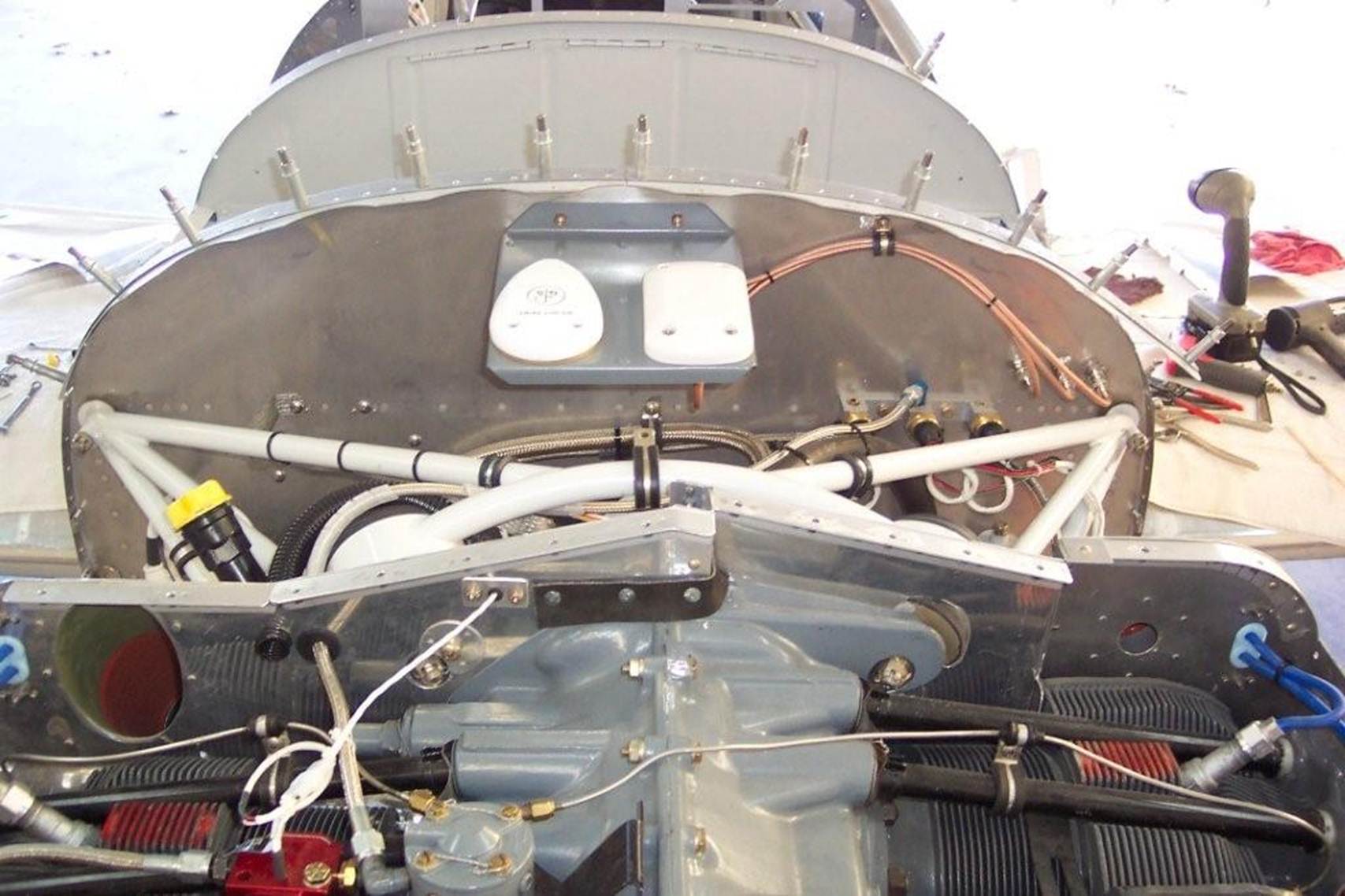

I have two Garmin GPS antenna firewall forward on the 8A and it works well. The only issue is Garmin suggests 6" separation and staggered from what I am told.
No way I would put them on my dash. Just too in your face. I try to keep the dash completely free of items.
Robin

Comm 1 and 2 are on the belly underneath the seats for me. All my GPS antennas (and GDL39) are under the cowl. All work great!!
