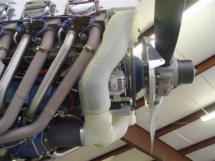

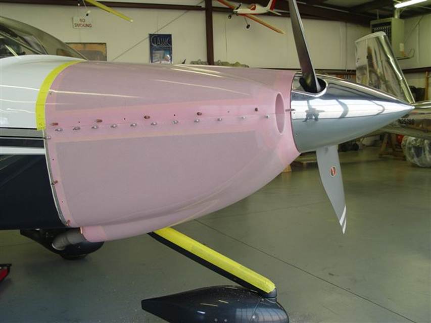

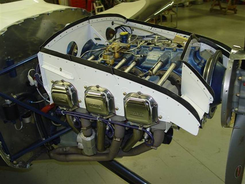

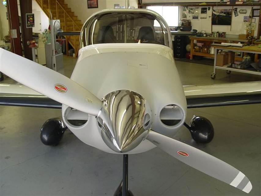

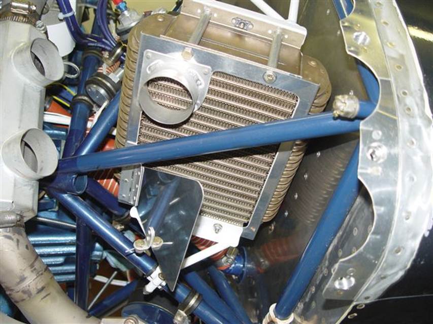

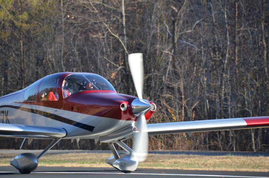

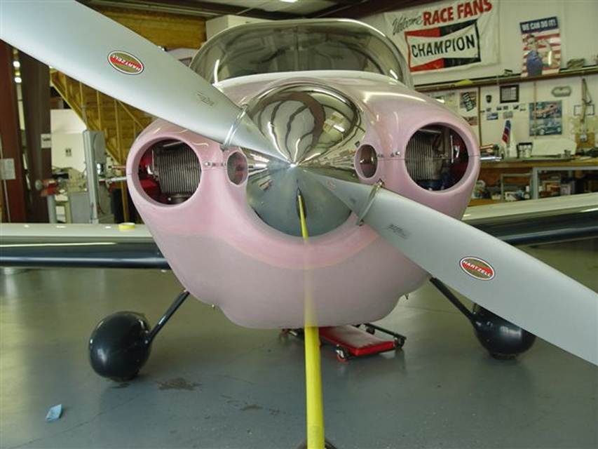

We are close to flying the replacement cowl. I wanted to share a few photos of the new cowl, baffles, oil cooler location including bracket. intake etc…
Robin
Can't you see the air molicules woooshing by the cowl?
I like having only 2 inlet holes.

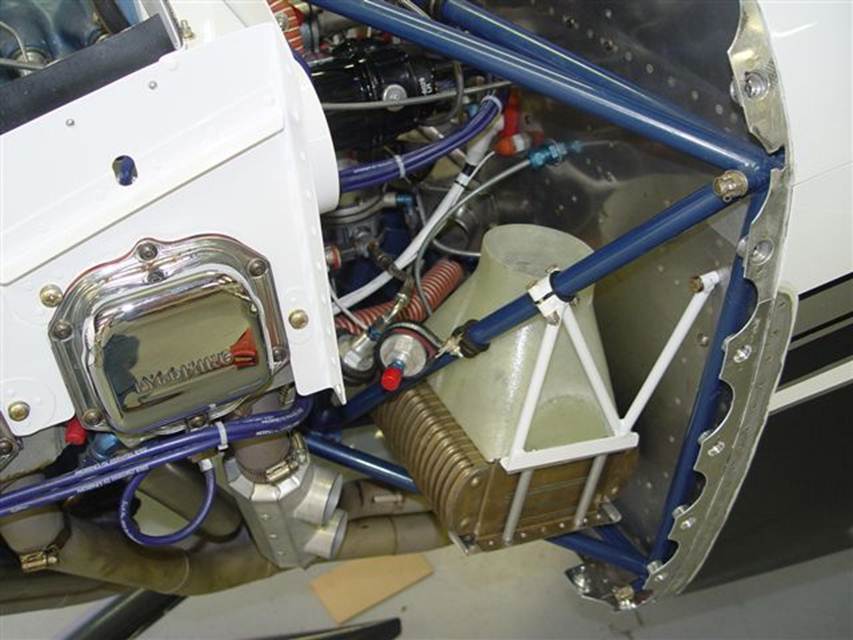

Engine looks pretty clean for 325+ hours.
Double Induction, double filter system. No Alt Air so yet.
Nifty oil cooler bracket

Is this a new SJ RV10 cowl? I don't see it on their website....

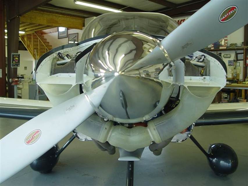

Would like to see a front view of the dual fiberglass intake runners.
Guessing you're not using a plenum.....

This cowl replaces the SJ cowl and plenum. Adios!
This is the new Showplanes and intake system for the FM300. No Plenum for me ever again.
If one were to visit the Showplane website you can see the induction system from the front view. Basically the bottom quarter of each inlet is dedicated to the FI induction system.
Robin

Do you plan to stuff some insulation between the induction air and the #1 exhaust?

I originally placed the SJ cowl on the -10 based on the 2 place RV fleet history with the SJ unit. I was probably the 3rd -10 SJ cowl flying. Unfortunately the SJ -10 cowl well documented problems meant that I needed to replace the cowl on my flying -10. The smart move would have been to go with the proven factory cowl. It does everything you need it to do and there are 350 other -10 pilots you can have something in common with when installing the Vans cowl. When my 8A came on line it was time to replace the -10 cowl. I opted for the new cowl even though I will most likely be the first flying production Showplanes -10 cowl because the builder has a long history of RV aftermarket product development and I had been in discussions with Bryan for about 2 years tracking his progress. He is extremely methodical in his development approach vs. just blowing up a smaller cowl and plenum hoping it works. My prior cowl & plenum were sold as a set intended to be used together but even a basic measurement like the inlet holes weren't aligned. That should have been a warning to me but I already had started the assembly. Bryan on the other hand had done so much R&D and his goal was to develop a "no compromises" cowl. A cowl that can fly with the standard Vans oil cooler on the wedge with no added louvers and cobbled together solutions required. When it came time I decided to support a builder & designer that gave great care in his development. I can say the quality of fiberglass far exceeds anything ever shipped from Vans.
Long story / short. The smartest solution would have been the Standard Vans cowl and it will remain so for most builders. But this cowl is great looking and works with the FM200 & FM300 so I am giving it a try. That is why I fly in the Experimental category for gosh sakes. Of course the first 325 hours I flew in the Disgruntled category but hopefully this new cowl will resolve those issues. The rest of the plane is a dream to own & fly.

Yes. It's tight up there.

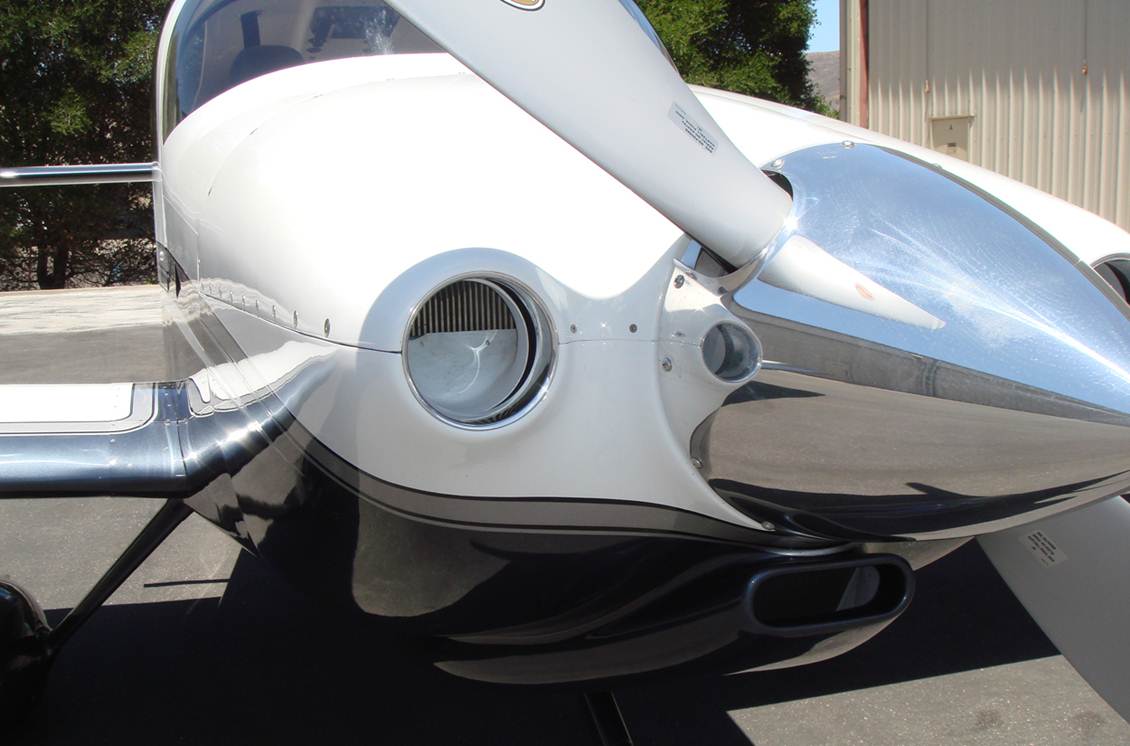

Someone asked to see the front view of the Showplanes cowl to review the FI inlet area.
Here you go!
Robin

Thanks - I was one of the ones that requested a front-view...
Here you go!
Robin
