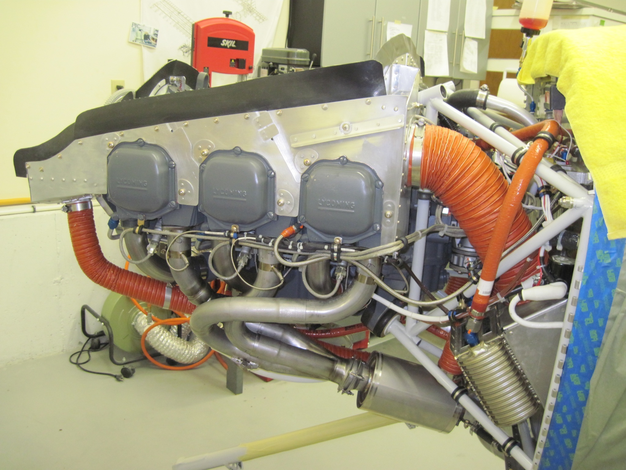

I ran mine in a separate clamp attached to the same valve cover screw as the ignition leads. I did not want to take the chance if an erroneous reading with the egt. In reality, the egt lines are such low impedance that the chance of it happening is slim. It was too easy to just use additional adel clamps...

PostPosted: Sun Jan 13, 2013 12:13 pm    Post subject: Cable runs Reply with quote
I'm curious what you guys did for the lip of the valve cover by the
screws. Did you add washers to lift up the contact area of the clamp to
clear the lip of the valve cover?

flying-nut(at)cfl.rr.com
PostPosted: Sun Jan 13, 2013 12:41 pm    Post subject: Cable runs Reply with quote
to clear the lip of the valve cover?
Yes. Standard practice!

flysrv10(at)gmail.com
PostPosted: Sun Jan 13, 2013 12:44 pm    Post subject: Cable runs Reply with quote
Yep, added washers.

The new LYCOMING engines come with a bag of washers and screws that are longer than the factory installed valve cover screws. The washers go under the clamps

That is what I do Sean, to ensure the valve cover is secure and to give the adel clamp a flat surface to rest on.

PostPosted: Sun Jan 13, 2013 2:35 pm    Post subject: Cable runs Reply with quote
Thanks everyone. That's what I figured, but wanted to confirm.
