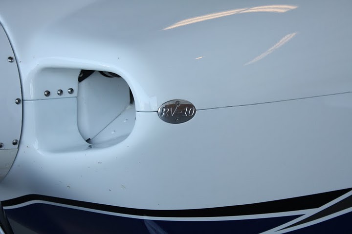

Amen to that Jesse! I had just the hing section for a long long
time, and while it did work, eventually the eyelet widens and the
pin can start to move and then the wear happens faster yet.
I did the JB weld thing for a while to hold it on, and that worked
ok for a while but soon one of them broke free and then I had to
re-glue it. Finally I got ticked off enough that I did it better.
I bought new pins, and a section of stainless hinge, and silver
soldered them together. Yes, Van's does sell a pre-made pin, but
by this point I was irritated and knew I could do a better job
if I took the time. Wish I would have had Van's pins right from
the start. Actually, if I could do it all over again, I'd
make mine look like Sean's where the pins get hidden by an
oval shaped RV-10 logo. That to me trims it out perfectly.

Here are the covers Tim was referring to. These are produced by Aerosport
Products.
Geoff Combs

PostPosted: Tue Dec 18, 2012 10:10 pm    Post subject: Cowl Hinge Pins Reply with quote
Can those be recessed? My buddy left his proud but seems like I've seen pics of them flush???

PostPosted: Wed Dec 19, 2012 2:55 am    Post subject: Cowl Hinge Pins Reply with quote
By design they are supposed to be recessed and flushed. Here is a link to the instructions.
http://aerosportproducts.com/Docs/cowlpin.pdf
