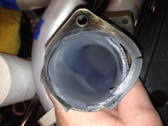

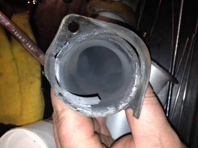

I just wanted to share an issue that we discovered during our annual inspection. This is just a bit embarrassing since we seemed to have potentially solved some issues that we have been having since shortly after we first started flying our airplane (450 hours). But unless we are willing to share our ‘embarrassing’ errors we will not save others from making the same mistake.
As some may know we have struggled to run anything near LOP without the engine ‘stumbling’, we made many modifications to help this situation and made significant improvements, but were never comfortable with the way the engine ran LOP. We blamed this on the James Cowl and Plenum installation; I am not saying our discovery takes the cowl and plenum off the table as contributing factors to LOP issues.
Lately, our CHT temps started rising, and we were unable to climb at altitude without getting the CHT’s above 400. We also noticed a fuel smell on takeoff, I have searched high and low for the source of the fuel smell. Our engine has always idled a little rough; we were told and convinced that this was caused by the fuel vaporizing in the injector lines since we had a tight cowl and plenum.
Then we gained a symptom that lead to discovering our problem. Lately our idle RPM rose to around 1050 – this was the symptom that got me looking for intake leaks. There it was, four of our intake gaskets were obviously leaking. We could see the gaskets were out of place, so I pulled all of the intake tubes and found some amazing gasket placements. The picture below shows one of the gaskets, this is as it came off the engine.
So after replacing the gaskets and performing the ‘rest’ of the annual a test flight was in order. Wow, someone hung a brand new engine! Keep in mind we have only done one test flight, so the data is very limited – but there was noticeable improvement. CHT’s down, no fuel smell, pull the mixture and the engine just sort of looses power without any stumble at all, idle speed down to 650. Also of note, during full power static run-up our fuel flow went from 20.2 GPH to 23.5 GPH.
I have a hard time believing that the engine was assembled with the gaskets out of place, I also have a hard time believing that the gaskets have not been leaking for some time, perhaps even very early on, and obviously getting worse.
There it is – our dirty laundry, hopefully this information is useful to others.

New - Lycoming - Thunderbolt
IO-540-D4A5
260 HP (Std Compression)
Airflow Performance Injection
Dual Mags
Thanks Jason
