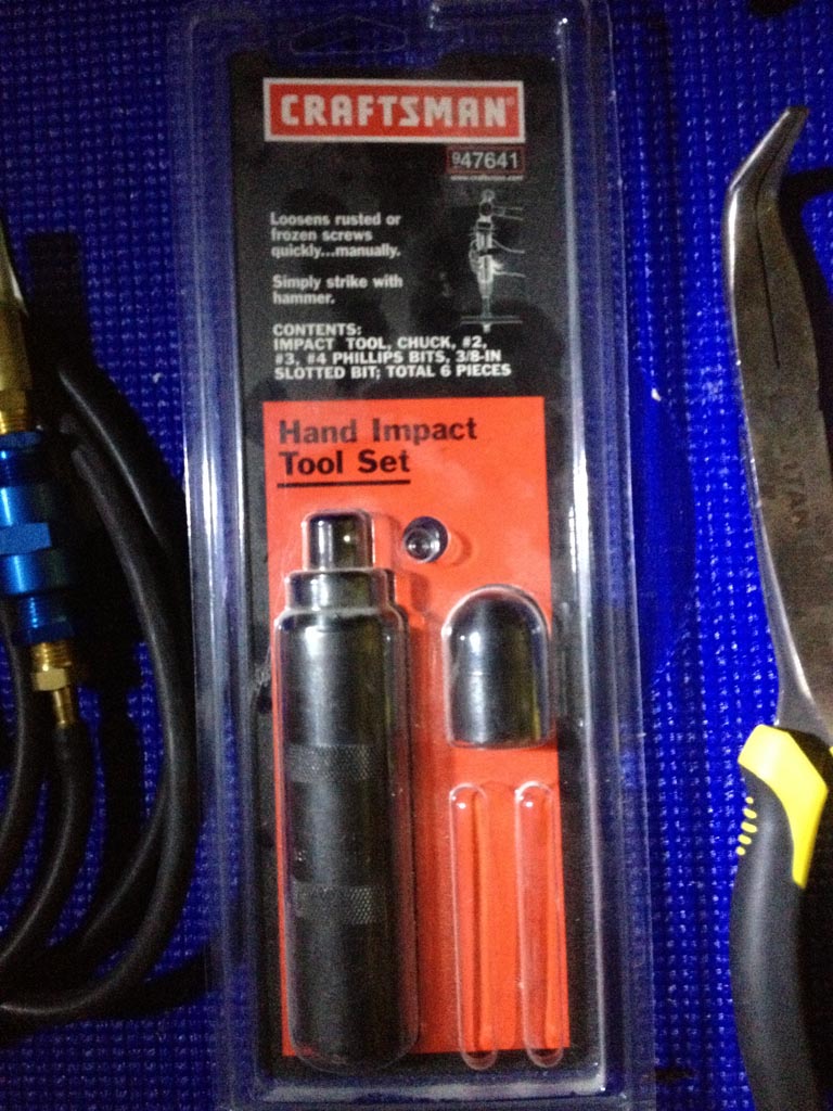

PostPosted: Tue Jan 01, 2013 11:14 am    Post subject: Removing magnetic plug from Rotax 912 gearbox Reply with quote
Friends,
This is the hand tool that can be used to remove the magnetic plug.
[img]cid:721F83DA-E04F-470D-894C-F1AA6BAA1BAC[/img]
It requires a 1/2" drive #40 Torx bit.
For specific instructions on removal of the magnetic plug see the instruction video at Rotax-Owner.com. They provide a quite detailed tutorial.
Blue skies & tailwinds,
Bob Borger

Happy New Year to all, and apologies for returning to an old topic...
Bob (Borger) had an option for a Sears tool that would remove the plug. Bob, do you have details of that (picture, part number?).
Best
Richard
Kenya
http://forums.matronics.com/viewtopic.php?p=391314#391314
Richard Lamprey
Joined: 15 Jul 2011
Posts: 95
Location: Kenya
PostPosted: Wed Jan 02, 2013 3:34 am    Post subject: Re: Removing magnetic plug from Rotax 912 gearbox Reply with quote
Thanks Bob, this may do the trick. I'll order one. Challenge I have is to get it to East Africa, but thats another story....
Tim, thanks, I have the new one, just need to get the old one out.

PostPosted: Wed Jan 02, 2013 4:41 am    Post subject: Re: Removing magnetic plug from Rotax 912 gearbox Reply with quote
Richard,
The impact tool that Bob used has been copied by the Chinese and is available at motorcycle shops and the like. You may be able to find it locally. The Chinese tool isn't high quality but you only need it to work once!
