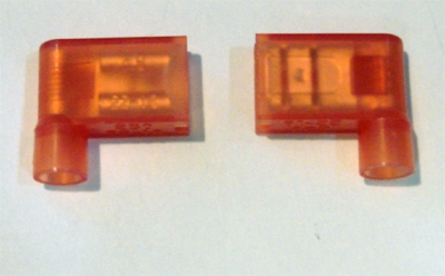

There ARE right angle fast-on terminals
[img]http://i.ebayimg.com/t/100-PCS-22-18-AWG-NYLON-FEMALE-FLAG-TERMINAL-RIGHT-ANGLE-ELECTRICAL-CONNECTOR-/00/s/ODg5WDE0MzI=/,iME+QBErs-NBP6lN4UNt60_1.JPG[/img] [img]cid:.0[/img]
But they are not PIDG and I'd be reluctant to use them
under the cowl.

Would something like pictured here: http://www.elliottelectric.com/Products/Detail.aspx?v=TAB&c=RA18250A
Do what you want?

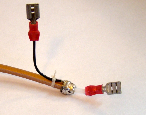

PostPosted: Tue Oct 09, 2012 11:33 am    Post subject: Right Angle Fast-on Reply with quote
At 09:54 AM 10/9/2012, you wrote:
For the baffle to coil distance, I will have to go measure but I think about two inches, perhaps an inch and a half. I am not concerned about it shorting out, but couldn't see how I could get the coax to coil up in the space present.
. . . not the coax . . . but connections
to the coax.
Try this:
[img]cid:7.1.0.9.0.20121009142330.01e26930(at)aeroelectric.com.0[/img]
Take your coax stripper and prepare a end as if you were
going to install a crimp connector. Except you crimp a
fast-on to the center conductor. Then fold the shields
back over the outer jacket and solder a 20AWG pigtail
to the shield. Put a nice string tie on the pigtail for
insulation insulation support and install another
fast-on. See if you can't install this termination
in the space you described.
As you can see here, the COAX can come STRAIGHT up to
the terminals without bending. Only the more
compliant conductors need be shaped to the task.
