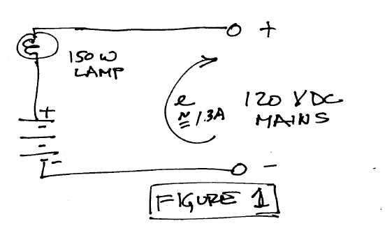

PostPosted: Fri Sep 28, 2012 6:36 pm    Post subject: Resurrecting a battery Reply with quote
Here's where my ignorance starts showing. Is this setup using mains voltage? Rectified and current limited? 120+ volts DC, current limited to 1-2 amps?
Yes. Suppose the power coming into the back of your
house was being supplied by one of the honorable
T.A. Edison power stations . . . 120 volts DC.
Okay, 150 watt bulb will draw about 1.30 amps.
Now hook a 12v battery in series with this setup
such that current flowing through the lamp tends
to CHARGE the battery. Voltage across the
lamp drops by 12v or so the current drops a bit.
But the lamp still burns brightly and current
through the lamp is charging the battery . . . the
lamp becomes a 100W resistor.
[img]cid:.0[/img]
Horribly inefficient?
Yes . . . unless you want to sit down and read a book
while the battery is charging and can make use of
the light output.

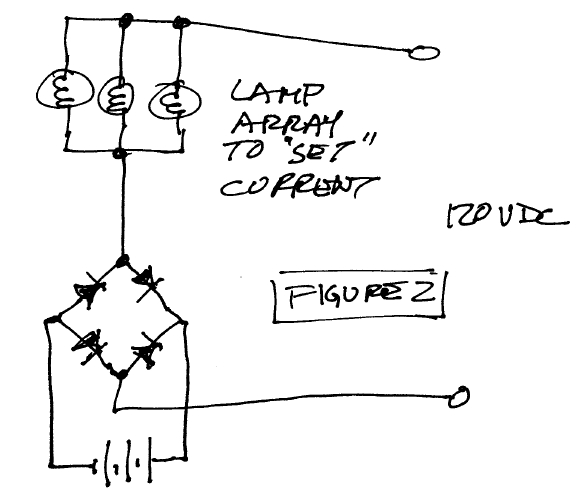

Now, consider a similar design goal but the power
delivered to the back of the house is AC. We can
add the rectifier such that reversal in the applied
voltage is rectified so that it always charges the
battery irrespective of line polarity . . . the lamp(s)
still limits the current . . . want a stronger charge
rate? More or bigger lamps.
[img]cid:.1[/img]
Again, only 10% of total energy consumed goes into
the battery . . . but it IS current limited. Probably
not a charger you want to build for routine battery
maintenance but it is an option for generating a
current limited VOLTAGE source that will RISE to what ever
level the injured battery will accept. If it goes to more
than 2X battery rating and/or if it doesn't begin to
fall in a few minutes, then this resuscitation gambit
is futile and should be discontinued.

Very clear now. 1 picture=1k words. I had the lamp on the DC side in my mind. I'll report back when I have something to report.
I assume there is no reason to put in a cap to try to limit ripple.
Naw . . . those molecules of lead and acid aren't picky.
