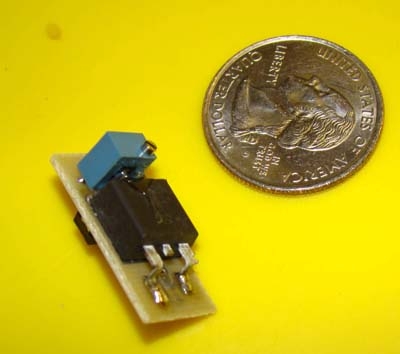

I fussed over packaging for some time. I was
looking for a process and materials that provided
adequate protection while keeping costs low.
When you have an assembled ECB this small
[img]cid:.0[/img]
How's the best way to package it? Potting (full
encapsulation) is messy, slow and makes the thing
difficult to diagnose for field failures . . . impossible
to repair.
The double melting wall heat-shrink provides an
envelope that can be put on in seconds, offers
good shielding from contaminants. It can be
cut away for repairs, field failure diagnosis
or re-adjustment.

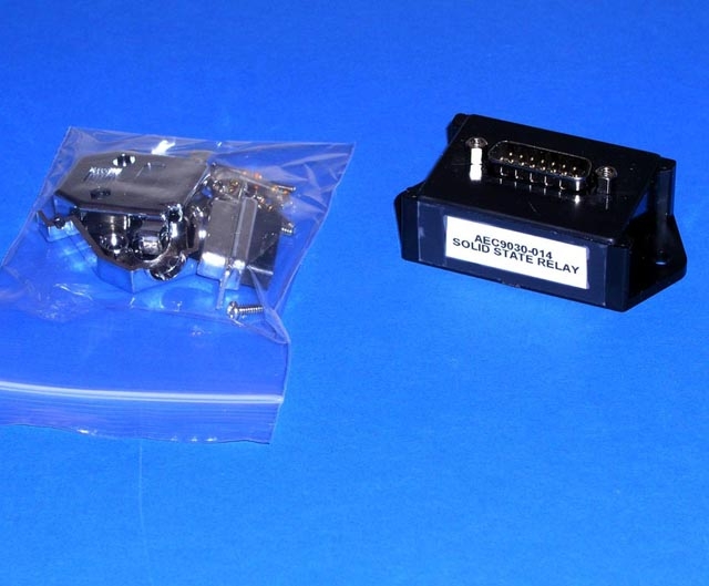

Our next line of products will be offered in
an enclosure like this:
[img]cid:.1[/img]
I have hundreds of plastic boxes with pre-cut d-sub
connector holes in the top. Cost of box and lid is
under $2. While the box is glued shut, it's fast to
assemble, easy to cut off, easy to replace after
repairs are made, etc.
I really considered reviving the CbOVM-14 in
this housing but that would ADD the costs of enclosure
and connector. Not consistent with my design and
marketing goals.
