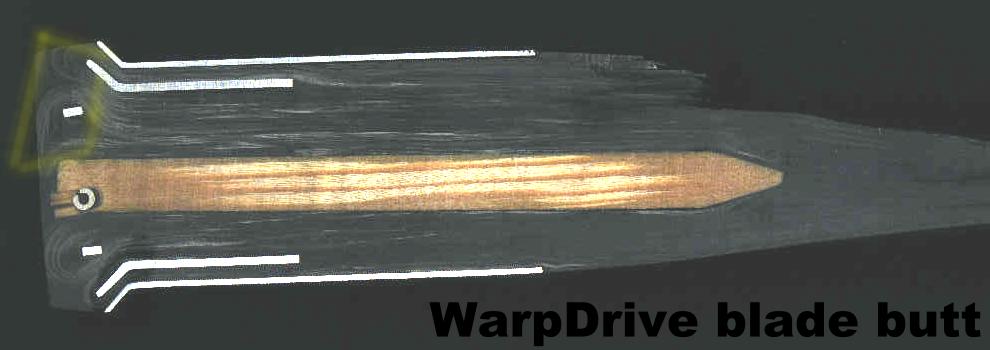

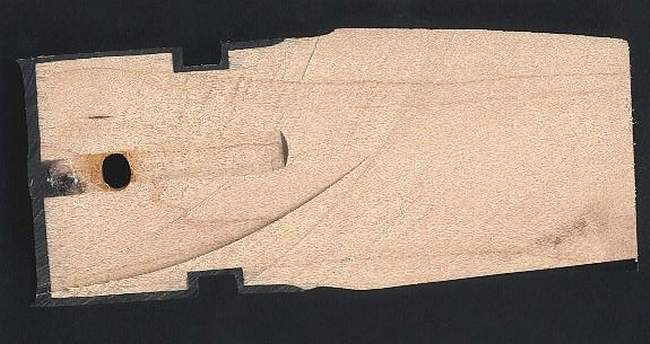

Had a 3 blade GSC prop fail, Sep 1993. Collected all 3
blades on the tail boom. Had to replace the tail boom.
Immediately started flying Warp Drive props, and have for
more than 3,000 WD since then, on 582, 912UL and 912ULS.
Attached are photos of GSC and Warp Drive Blade Grips. No
comparison between the two.
