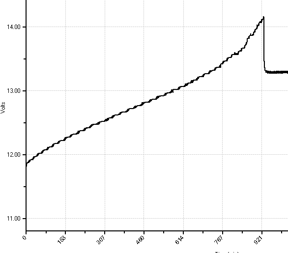

A more recent plot I published a few days ago for my Battery Tender
Jr. had a recharge curve for 12 a.h. battery that looked like this:
[img]cid:.0[/img]
Not much of a top-off cycle. No absorption dwell . . .

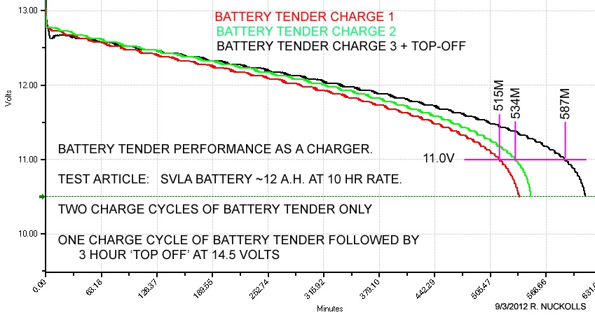

So I ran some new plots on Ron's 12 a.h. batteries and my
10 year-old Battery Tender. Here's what I got.
[img]cid:.1[/img]
These plots confirm the question as to whether batteries 'charged' with
the Battery Tender really get topped off. Two cycles of Battery Tender
only recharge produced the red and green plots. A third cycle was
augmented with a 3 hour top-off which was still drawing about 150 mA
at 14.5 volts.
The third, topped off cycle stored about 60 minutes more service
at a 1.2A rate than for the un-augmented cycles.

Does that mean they're 'bad' chargers? No, in instance under
study the Battery Tender still put ~90% of the battery's total
capacity back in storage.

I've given away all my SEC1562 chargers to family members.
Got a new one ordered yesterday. I'll run some charge/discharge
cycles on the same battery. I think we'll find that the Minders
and Tenders are not designed to top off SVLA batteries of any
size.
I've used the Battery Tender to charge and maintain a family
of instrumentation batteries for years. I retired a couple
of test batteries last year that were over 10 years old
and tested to better than 75% of new. So it MIGHT be said
that cycling a battery less aggressively is good for
service life . . . but for sure, the battery maintainer
products are best used to store batteries that are fully
charged when put away.
The next chapter will be written when the new 1562 gets
here. Given the very reasonable price ($20) it may well
be that the SEC1562A is about the best value out there
for a top-off charger-maintainer.

> I have known this for some time (since the time I gathered
> the plots at: http://tinyurl.com/8o65jha and http://tinyurl.com/9paguuy
> at 14.5 volts.
> size.
> Bob . . .
