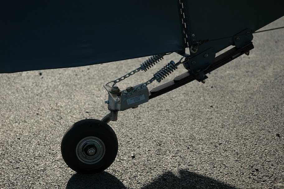

Thanks for the helpful suggestions. I went with a Matco. The Kolb handles so much
better....more like a real taildragger.
on my narrow strip.
" I would recommend installing the tail post brackets on all Kolbs I just
Ellery Batchelder Jr. "
Can you show a picture of this tail post brackets ?

http://forums.matronics.com//files/matco_tailwheel_143.jpg

I installed a matco tailwheel on my slingshot. Had a lot of
trouble ground looping cause the wheel would 'break' too
easily. Ted C
Ted C/Kolbers:
Do you have differential braking?
I'd have a difficult time flying my mkIII without
differential brakes.

With a full swivel tailwheel and differential brakes, ground handling in tight places is very easy and I'm glad I have them on my Slingshot. Balancing wheels/tires is pretty simple with the go-kart wheel balancer.
 Filesize:  160.78 KB
 Viewed:  11620 Time(s)
