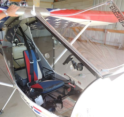

Here is one photo of a original top notch example.

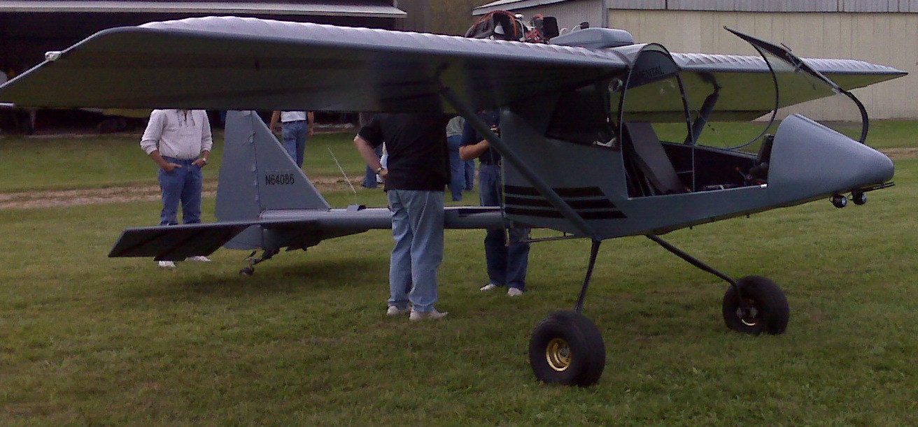

The Slingshot has the same basic fuselage as the Firestar. The canopy on the slingshot hinges (piano hinge) on the left side so the whole thing tilts over completely out of the way for easy entry/exit. Attached is a photo of my Slingshot with the canopy open.

I did not build this Slingshot so I can't guarantee that it is factory stock canopy, but suspect it is because all the slingshots I've seen up close (4 so far) had the same canopy arrangement.
