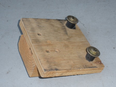

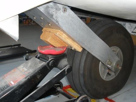

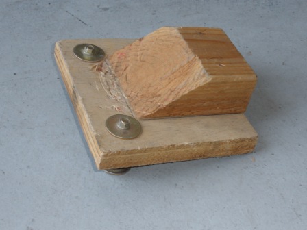

PostPosted: Sun Aug 12, 2012 12:41 pm    Post subject: Jacking block Reply with quote
This jacking block is clear at the other end of the spectrum from some of
the engineering marvels that have appeared on this thread, requiring just a
couple of pieces of scrap wood, a bit of hardware, and half an hour of work.
It has traveled around in N135TD for 11 years and 800 hours without ever
being used away from home, but it is worth the pound of extra weight in
reduced worry over having a flat at another airport. The idea is not
original with us, having been passed around the Europa group many years ago.
Dave DeFord
N135TD
