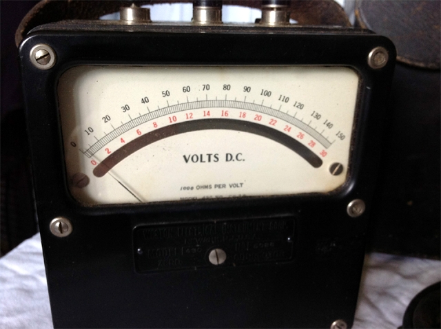

earliest precision voltmeters (ammeters with resistors
in series) were excellent demonstrations of the
best-we-knew-how-to-do at the time.
[img]cid:.0[/img]
Note the label at the bottom of the scale=plate that
says "1000 ohms per volt". This is another way of saying
that this instrument has a basic sensitivity of 1 milliampere
full scale and when making a reading on the 150 volt
scale, the instrument presents a "load" to the circuit
being measured of 1000 x 150 or 150,000 ohms. It will
"draw" 1 milliampere of current from the measurement node
at 150 volts.
These instruments were a grade trade off between
sensitivity, accuracy, linearity and calibration drift
due to temperature and age. But an instrument like
this is fitted with a 'mirrored scale'. The observer
lines up the pointer with the reflection of the pointer
so as to drive parallax error to zero. This instrument
could be both read and relied upon for readings with
certainty of 1% or better.

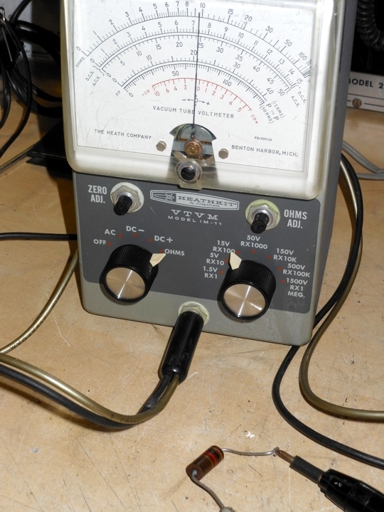

was achieved with some form of amplification. A
exemplar instrument is shown here:
[img]cid:.1[/img]

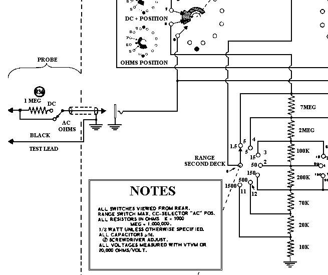

This Heathkit product has an input circuit that
looks like this:
[img]cid:.2[/img]
Notice the voltage divider of resistors that total up to
more than 9 megohms. Notice too a 1 meg resistor built
into the probe. The input impedance for this instrument
is over 10 megohms. Further, probing a node with a
combination of DC volts of interest that also carries
some signal (perhaps even high frequency RF) is only
very slightly affected by the probe. This instrument
is several hundred times more sensitive than the
device at the top of the page.
This kind of instrument may also have produced an
anomalous reading in the de-energized condition.
Modern digital voltmeters have input impedances on
the order of 20 megohms. Further, they do not provide
any isolation for probe-effects when measuring 'busy
circuits'. I have crafted a x10 probe for my Fluke
multimeter from an low capacity, oscilloscope probe
to conduct the kinds of measurements I used to do
with my Heathkit VTVM. Also, I have some load resistors
I can stack onto the voltmeter's test lead jacks that
deliberately degrade instrument sensitivity so that
readings are not influenced by small leakages.
[img]cid:.0[/img]
    at 150 volts.
[img]cid:.1[/img]
   looks like this:
[img]cid:.2[/img]
    The point of this soliloquy is to remind us
    that not all observations provide good data
    . . . but all data can be filtered through a
    healthy level of skepticism supported by an
    understanding of the circuit under test along
    with the measuring device's limits.
Mickey Coggins
