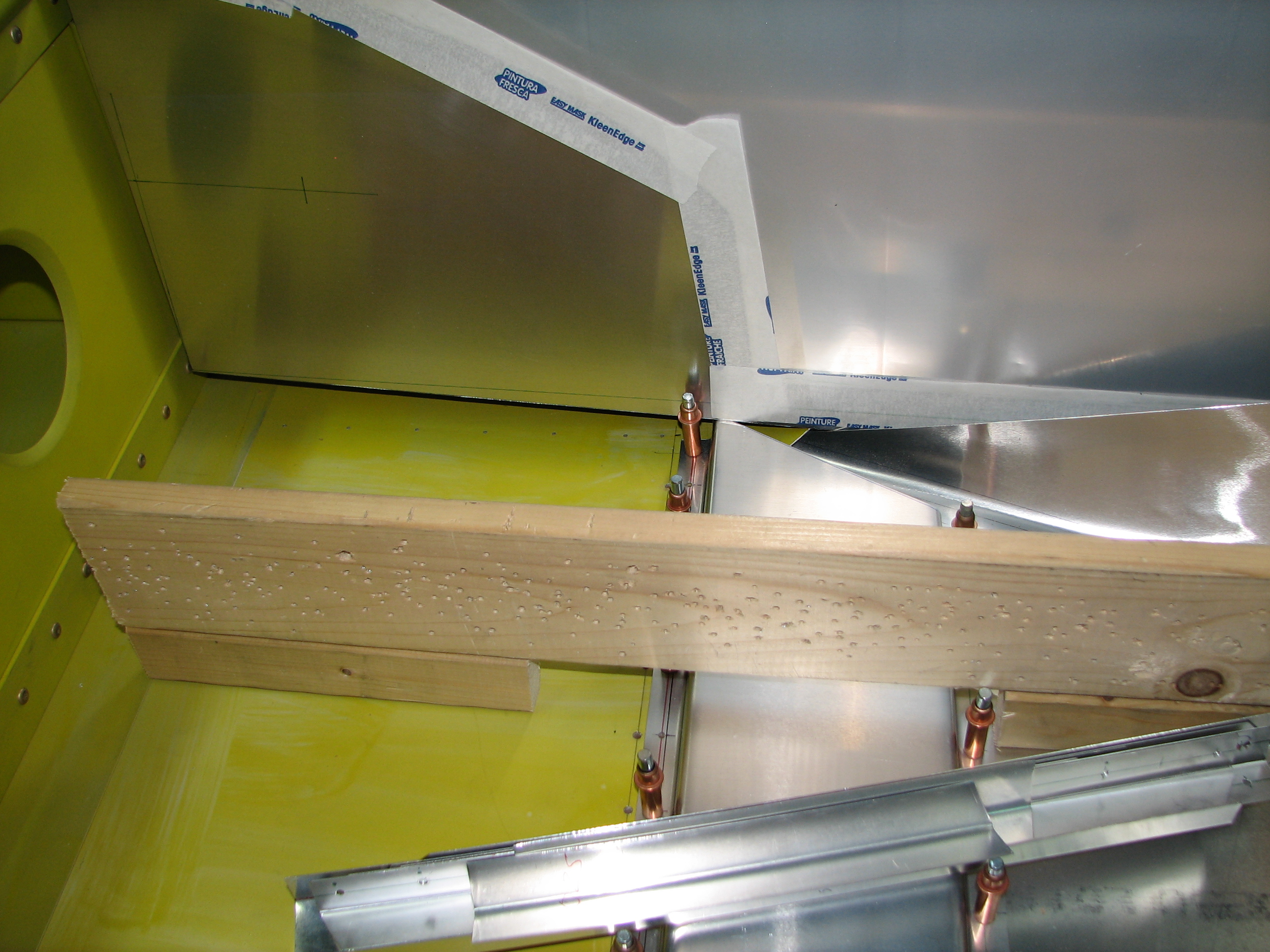

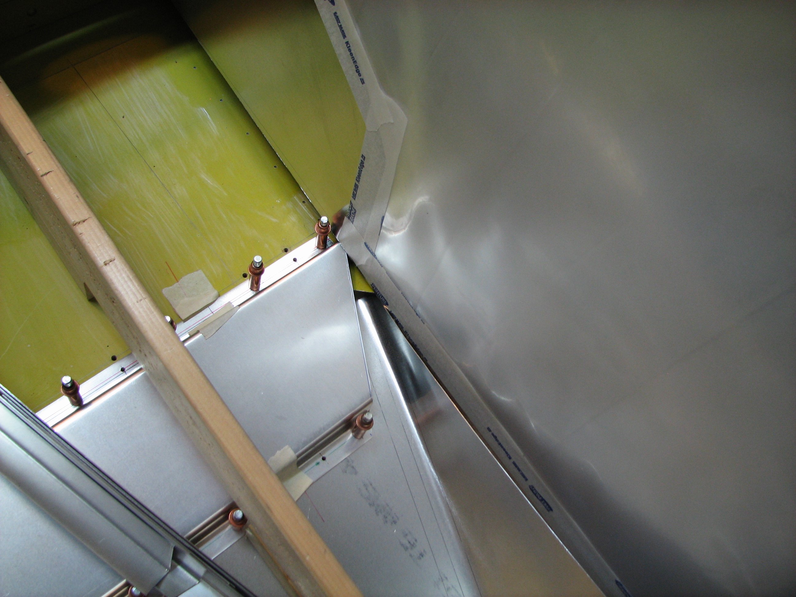

Hello, folksMy aluminum stack is finally starting to resemble an aircraft (if you have a lot of imagination, that is): http://www.zenith.aero/photo/img-6058When I put the front side skins in place (just to have an idea of what it would look like), I noticed the interference between the side skins, heel support and floor (the rolled end of the floor). The attached pics show the offending area.The instructions simply say "trim as required" (or something like that). To me, it seems I'll have to remove a semi-circle one or two inches in diameter - as I haven't seen any comments about this, I am a little concerned. I also have looked at a few of the CH601 sites still on-line, but I did not find any picture or comment that would clarify this. Thanks in advance for your comments / suggestions CarlosCH601-HD, plans

jaybannist(at)cs.com
PostPosted: Sun Jul 08, 2012 5:32 pm    Post subject: CH601-HD(S) fuselage assembly Reply with quote
Carlos,
I'm not sure when it started, but I discovered this problem (with my 601XL) in June 2006 and reported it to Zenith. They published a revised photo guide page, saying that it had to be trimmed. (I had already done that) I think they revised the part after that, but I really don't know if they ever revised the drawing for the part.
Jay

bryanmmartin
Posts: 1018
PostPosted: Mon Jul 09, 2012 3:43 am    Post subject: CH601-HD(S) fuselage assembly Reply with quote
I would trim the corner of the heel support, it's non structural. Trim the side skin only if necessary.
