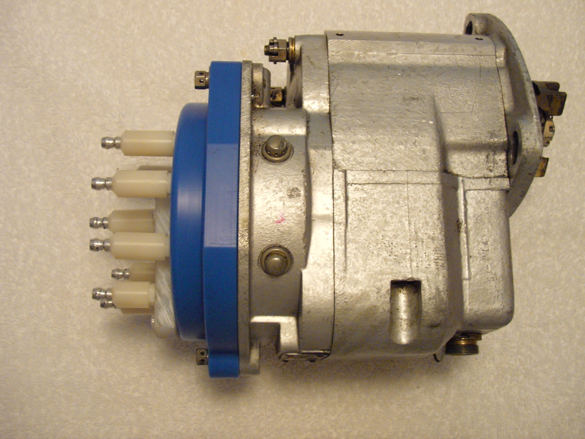

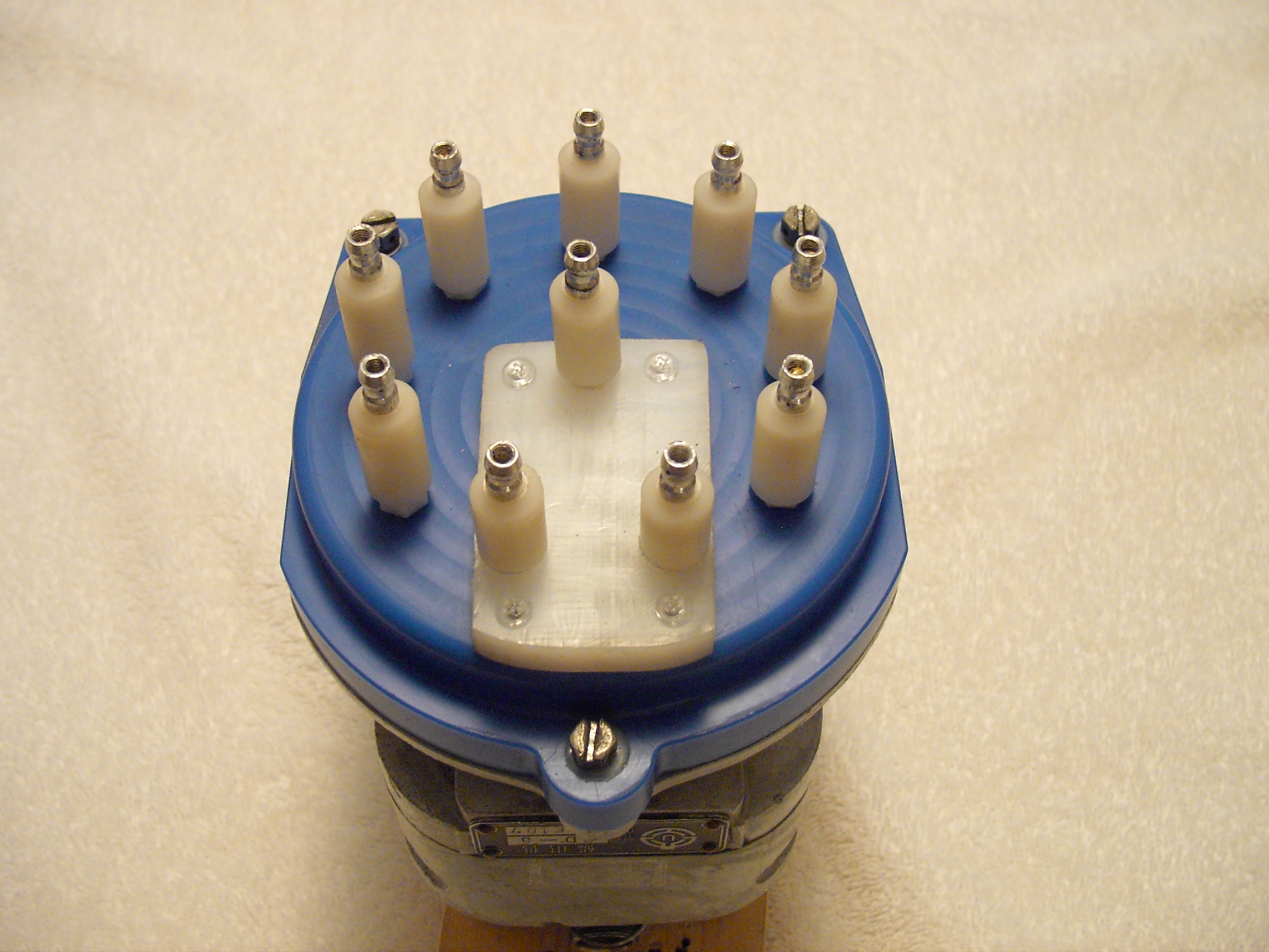

Here is a look at a prototype of a distributor cap I'm developing. It is designed to work with automotive wire on either a standard magneto or a magneto converted to Electronic Ignition. This configuration secures spiro-wrapped wire more securely than screwing a pin through it with the stock cap. It also has wider contacts for a slightly longer firing time to facilitate the multiple spark feature in EI.
Notice that 1 piece replaces both cap and cover. Larger 10mm wire for high energy systems can be used if desired.
See it at Oshkosh, I'll bring it up for the maintenance seminar.

GOOD IDEA!

Great idea Craig!
