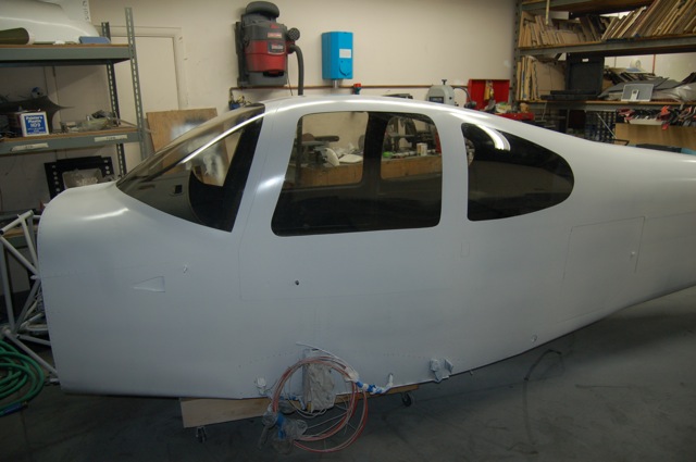

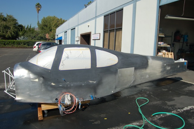

With regards to making a dolly to move the fuselage around. I adapted some tires during construction to allow me to roll the fuselage around.
Pictures are attached.
Fuselage remained low to make it easy to work on and It was easily moved around.
Jim Combs

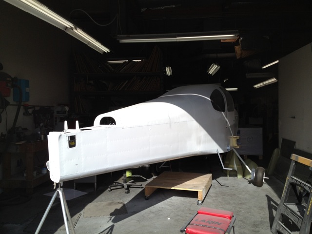

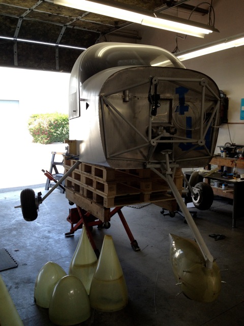

I'm in the printing business, so we have a lot of pallets sitting around. The larger ones, with big runners, make perfect platforms for building the fuse. I put a set of wheels on one and it was quite handy. When it came time to lift the plane up to put it on the gear, or to lift it off the ground (once on the gear) to fit the wheel pants, I just slid a scissor jack under the pallet and up she went:
