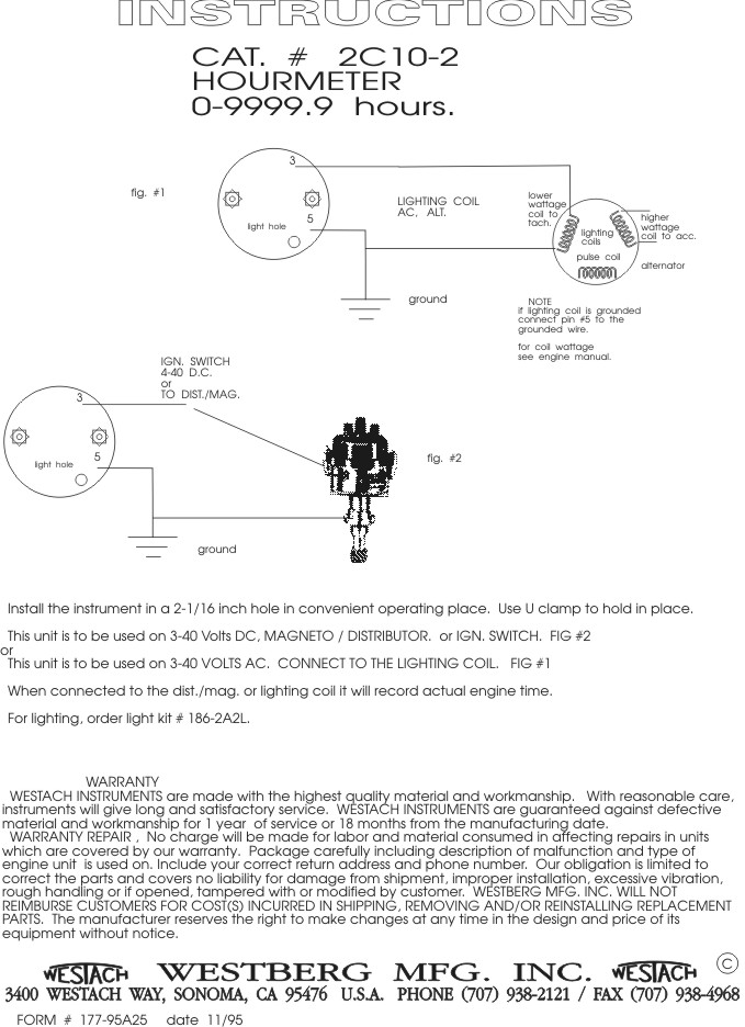

I have finished all the wiring of using Z-17 for a Rotax 582 powered LSA. The last thing I have is to install is the hour meter. It's a Westach 2C10-2 that I want to run off the AC side of the voltage regulator. Can I use the instrument panel ground bus or should I give it its own ground. Should I put a diode on the instrument panel ground? Should I use a shielded wire for the power connection?

If you run it directly off the two AC wires from
the PM alternator. No grounding necessary. No shielding
necessary. Don't the instructions for it describe
an AC connection?

Bob, Yes, as you can see they show one side of the AC leg going to ground.

Not exactly. Read the Note on the drawing you provided. They say IF one leg of the AC is grounded then pin 5 should go to the grounded leg. It doesn’t say that it should be grounded, only that if it is then pin 5 is the grounded pin.

Thanks, Bob, I didn't catch the note.
Rick
Hmmm . . . separate winding for the tachometer. Your
AC power to the rectifier/regulator cannot be grounded
on one side so that you can have full-wave rectification.
This tach coil is a very low power source. Do you have
an electronic tach reading this output too? In any case,
exactly where it grounds (if at all) is of little
consequence. These two systems are neither potential
antagonists nor victims. Does your tach wiring call out
grounding of one side of the signal wire?

The tach has its own signal wire. None of the Rotax wiring diagrams for the various regulators has an AC going to ground. As pointed out, the note on the drawing for the hour meter says if one of the AC feed wires is grounded that wire is used for pin 5 on the meter. Otherwise the two AC wires feed the meter and it makes no difference which goes to the meter connections.
