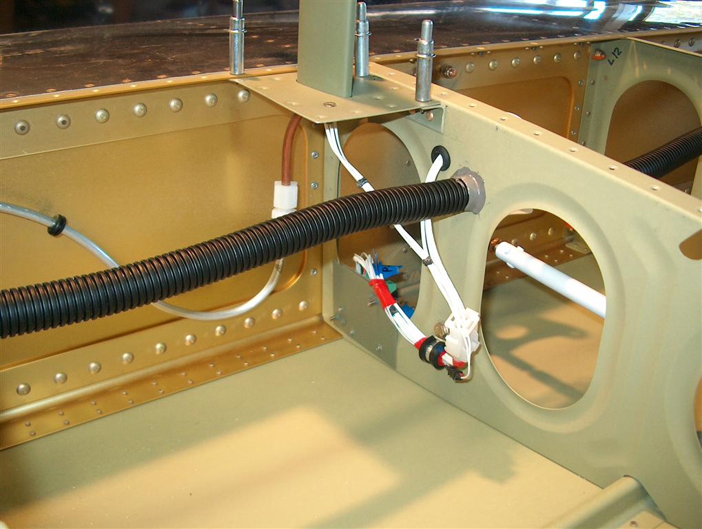

I thought it would be easier to install the gretz using molex connectors for
the wires so I mounted the assembly just inside of the wing rib inside the
inspection plate. I split the wires leading from the pitot to the control
unit and added appropriately sized molex connector. The thought being that
installing the pitot is just a matter of snapping the molex connector tight
instead of trying to work those little screws while upside down.
Not flying yet so as to effectiveness and reliability.... WAG.

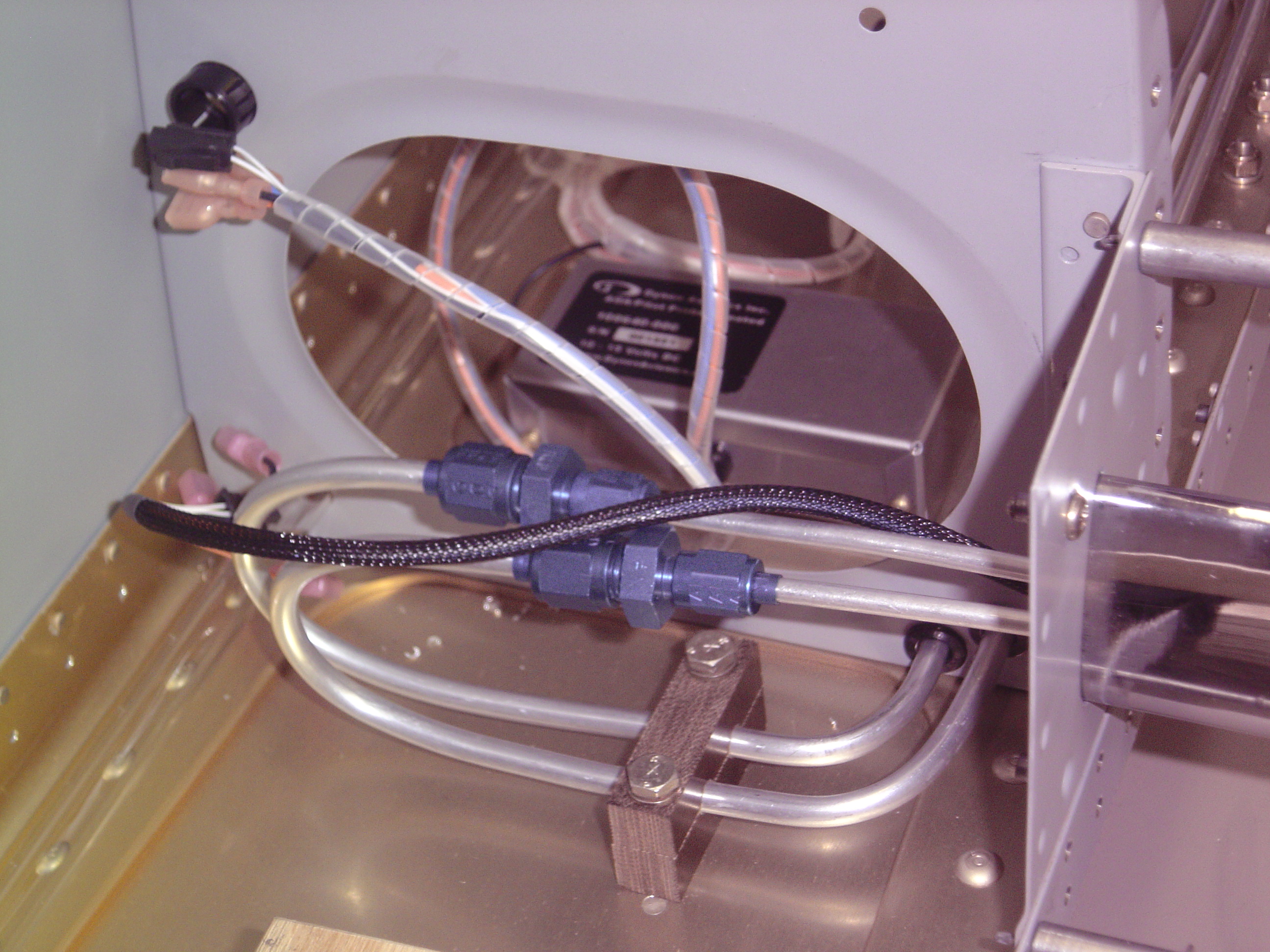

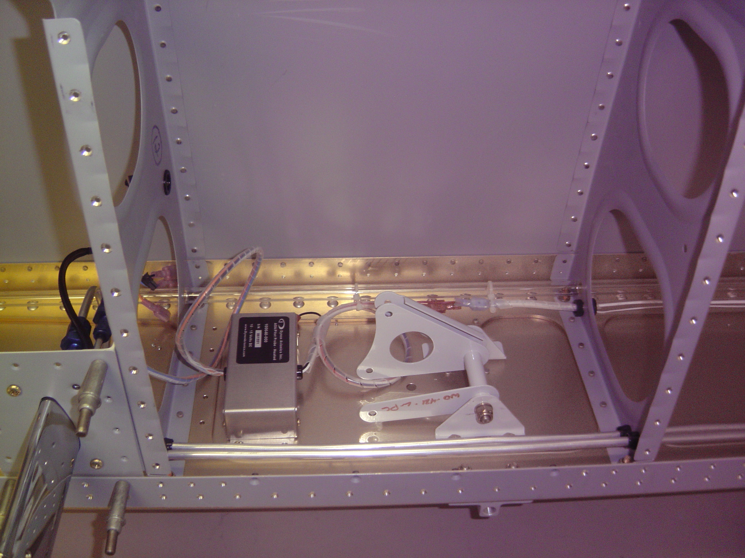

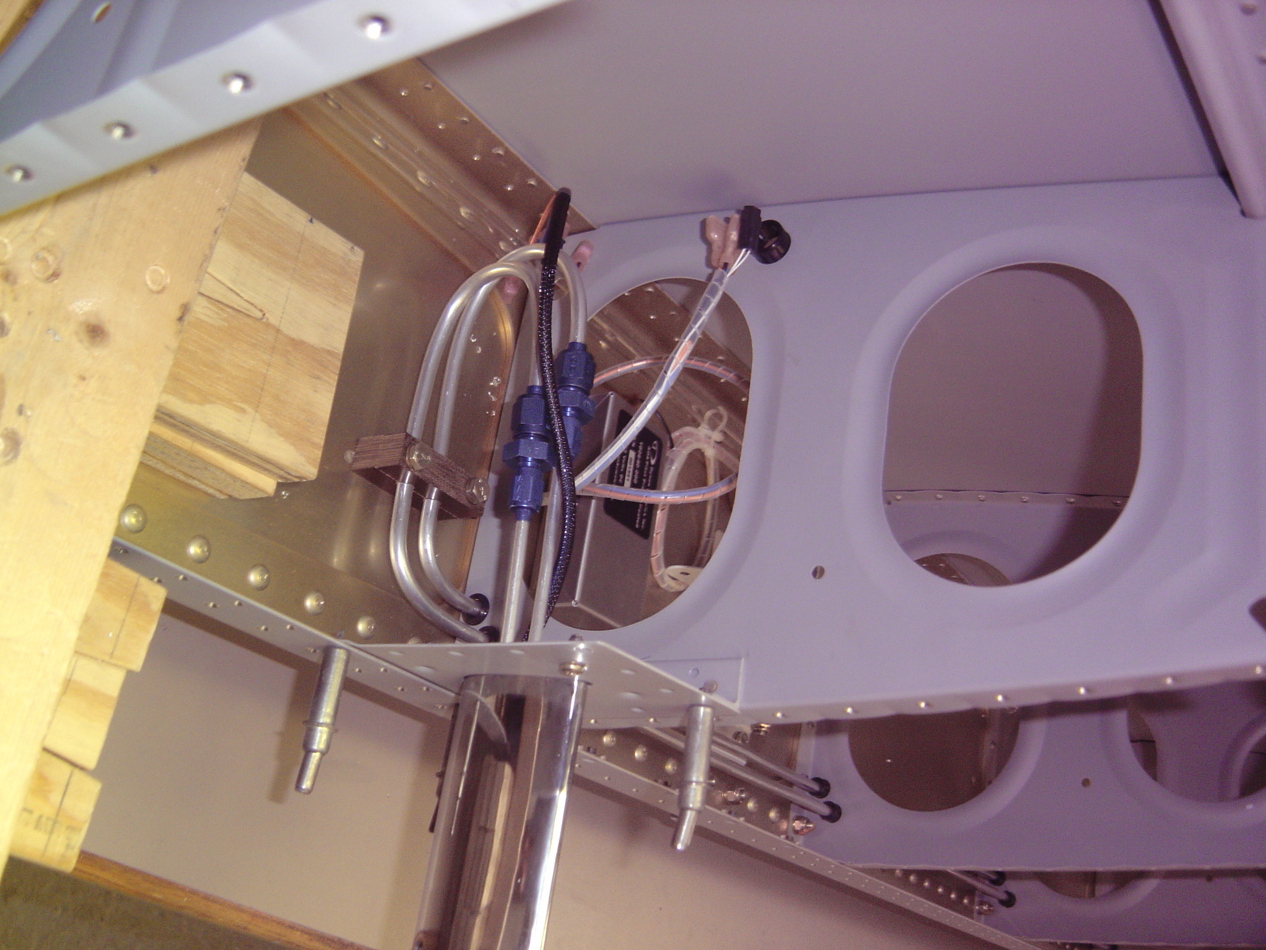

Dave, I don't normally post but I think my installation worked out well.
I have posted three different views. I would not place the controller
outboard of
the rib. The two AN3's are easily reached thru the access cover.
Ron Mara
Addison, Texas

PostPosted: Wed Apr 25, 2012 7:17 pm    Post subject: Gretz Pitot & Aileron Trim Reply with quote
Sorry, size restriction... here's the third photo.
