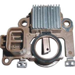

PostPosted: Mon Apr 02, 2012 3:01 pm    Post subject: Converting to externally reg alternator Reply with quote
At 03:09 PM 4/2/2012, you wrote:
Yes but,
I seem to recall a modification procedure that did not require machining any part of the case. It also did (as I recall) have you completely remove the internal regulator. So the process of conversion was different as I recall. All accomplished with simple hand tools. Perhaps Bob will chime in with his recommendation.
Bevan
A successful mod has more to do with understanding the
manner in which MOST internally regulated alternators
are wired, deducing the precise mechanics that accomplish
this in YOUR alternator of choice and then doing the
minimum chop, hack and solder to achieve that end.
Most commercial off-the-shelf alternators have one brush
wired to a (+) source of power internal to the alternator.
Identifying and isolating the (+) brush connection is key
to the mod.
http://tinyurl.com/8a9uuns
PlanePower no doubt breaks this connection and brings it to
the outside world so that external power can be routed inside
by way of a circuit breaker upstream of a crowbar ov module.
In this case, they leave the (-) brush wired to the pull-down
collector or drain of the built in regulator so that it can
continue to function at what it does best.
If you want to run a classic pull-up regulator with this
alternator, then you permanently ground the (-) lead,
you still bring the (+) lead out to the external regulator.
Here's the 'rub' . . .
[img]cid:.0[/img]
Most if not all "regulators" are housed in some
molded enclosure that includes brush holders. Identifying,
exposing brush connections, making reliable connection to,
and bringing leads out is not something one can write
a detailed, step-by-step instruction for. I could
probably mod about any alternator in 30 minutes but
that's based on a good working knowledge of alternators
in general. Take care that you do not alter the
spring geometry that keeps the brush in contact
with the slip rings at an optimized pressure for the
design.
I could write s-b-s instructions for any particular
model and brand . . . but suppose YOUR model and brand
is different?
I'm fairly certain that a mod can be done to about
any alternator without having to machine the case.
It's been 20+ years now so I'm not sure I recall why
the B&C mods DO machine the case. I think it's to
effect a nice mechanical connection of the (-) brush
with case ground using a spacer and screws. You don't
have to go that route, wires work too.
THEN . . . after slaying the (+) (-) brush problem,
you need to decide what, if anything, is best to be
done with the internal regulator. Simply isolated it
and leave in place -OR- pry it out and put jumper
wires in to take the brush holder wiring to the
outside world through the stock terminals on the
back of the alternator. I think you may find that
alloys used to fabricate bond-wire tabs for the
internal regulator's electronics assembly are not
very solderable . . . at least with our favorite 63/37
electronic grade stuff.
It has been suggested that the reason I don't offer
instructions for such mods on aeroelectric.com is
because I'm protecting a friend's market for modified
alternators. In fact, any article offered by me on anyone
else will be specific to one series of alternator of one brand.
I have oft suggested over the years that local alternator
shops could probably mod about any alternator you would
bring in the door. It's their business to have practical
knowledge of MANY alternators . . . which is beyond the
'scope of what I want to spend time on. If you study
and understand the alternator you have in hand, the
chances are you'll craft your own successful mod. But
just as weeks were spent fine-tuning the B&C offering
in search of the elegant solution, you'll spend a
significant amount of time doing yours for the first time
as well.
A great opportunity to learn something. If anyone
carries out a successful mod and bothers to photograph
the various steps, I'd be pleased to publish the
sequence on aeroelectric.com
Be sure to identify the 'victim' . . . preferably
by Lester number. This will greatly increase chances
of your efforts being useful to others.
