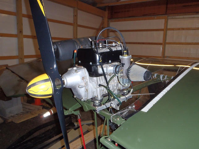

I have a 377 on my Firefly. The provision 4 takes an "A" gearbox while the provision 8 takes a "B" gearbox(plus others). The Ski-doo snowmobiles have neither provision and you must use a belt reduction drive.

I bought the firefly last year and have not flown it myself yet. I do have a video on CD of take-offs and landings with the 377 from the former owner. I would gladly send you a copy of the video.
I have an extra 447 waiting to swap on if needed, but the former owner/builder said he loved the 377 as it was a smooth running engine with plenty of power for the Firefly.
Shoot me a message with your address and I will get a copy of the CD in the mail to you. I might even have an economical engine for you!
