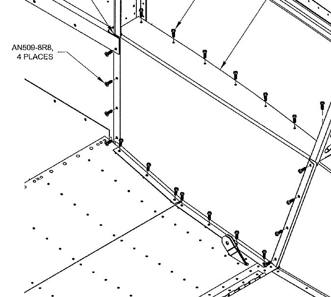

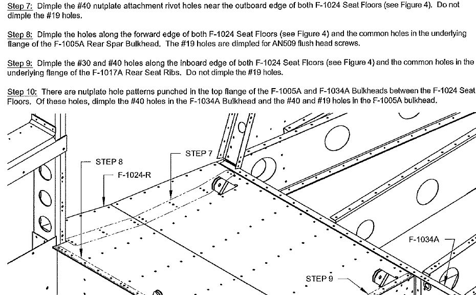

I finally finished running all (I hope) of my wires and conduits to the back and began the process of permanently installing the baggage and rear seat floors.  While installing the nut plates in the rear seat floors, I noticed that Van's had specified k1000-8.  Well these didn't work since the #19 holes were dimpled.  I grabbed the k1100-8s and merrily went on my way.  It wasn't until today that I noticed I was not supposed to dimple the #19 holes [img]cid:gtalk.320(at)goomoji.gmail[/img].
Herein lies the issue.  I have completed riveting the rear baggage floor ad seat back hinges.  It just looks like these are for the access cover and I can dimple these as well.  Do you think I need to fix this?

Your proposed substitution should work fine. No need to fix anything.

I did the same thing and it worked just fine and looked good to.
