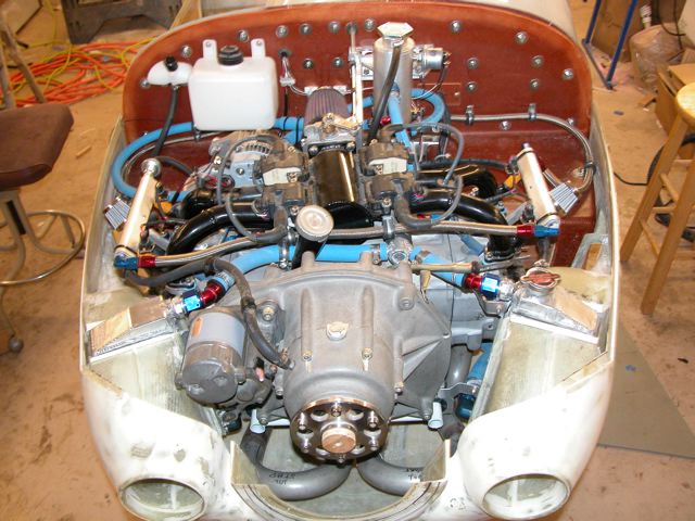

This seems to be a very nice engine for the Europa, a Viking Honda aircraft engine. The Viking shop in in Edgewater, FL. Do you know anything about this engine? It is the Honda 1500 cc, 117 hp, 6300 rpm max, 2.33/1 reduction drive, fuel injected, liquid cooled, 178 lb dry weight, fully developed package for aircraft use. The package includes 40A Alternator, Dual Engine controllers, Exhaust / Muffler, Air intake, K&N Filter, Starter, Radiator, Oil cooler, fuel pumps and Engine mounting for your airplane. The engine is fully assembled. $13,000 Looks like a very good alternative to the Rotax. They haven't yet but likely to develop retro fitable turbo-charge down the road.

Bill, It sounds like a great option, but if you talk to the various folk who
have fitted anything other than a Rotax to a Europa, I guess you will be a
bit wary about being the first one to try it! Regards, David Joyce, G-XSDJ

This engine is being sold by Eggenfeller.........formerly selling the Subaru engine conversions. Those Subaru engines turned out to be completely unreliable and downright dangerous. I know nothing about his latest project, the Honda conversion, but based on his previous engines, I wouldn't trust him. Google his name and you'll get a real education.

Yes I too looked at this option but as garry points out, and without knowing
Eggenfelner, I saw a lot of negative stuff on the web and also you see quite
a few of his engines for sale...being changed out for something else. This
generates a significant degree of caution in me at least. He might well
have got it right this time.
I think the base Honda fit engine is a very interesting powerplant and the
volume and quality control is unlikely to have the manufacturing problems
that the aviation manufacturers have like dodgy cranks but I am personally
am not up for the experimentation process required to get it flying.

fwiw, I've subscribed to his email group list and have been watching the banter with interest. I too have heard not-to-good things about the fellow. His on-line demeanor, and his answers to my in-person questions to him at Osh two years ago suggest arrogance.
My issues with the design are 1- the prop turns the 'wrong' way. 2- he uses a rubber coupler in an attempt to deal with harmonic resonances, and from my EAA chapter colleagues experiences (with other redrives) and also my research on this topic, this damper will not be able to dissipate the power at the resonance peak (typically at lower rpms and power settings... just above idle) for any extended durations. When asked about this design he didn't really answer it other than stating that the built-in fan 'blades' in the starter ring gear were designed to cool it.
I think the Honda block has promise tho - it's the same engine that is raced in the amateur leagues, and also the same one they use in their outboard marine engines.
Time will tell I guess whether his installation is more sound than his previous efforts with the Subarus

I looked at using auto engines in my Europa - the applications (car versus airplane) are just so different. While the base cost of these converted engines seems attractive, the problems soon run the cost (and the aggravation) far above the cost of a Rotax - just started my 912S and am impressed with it. Like all German/Austria equipment, if maintained by the book, they seem to run forever. After nine years of building the last thing I want is to experiment with an engine generally backed by an undercapitalized entrepreneur.
If you are just starting your build, my advice is to wait to buy. One never knows how long it will take to build and any savings in buying the engine earlier (prices do go up with inflation) are eaten up in maintenance on dried-out o-rings and required updates that are standard for new engines. I looked at the 912S when I started the build in 2003 and it was $15K or so list, and in 2010 bought my engine for $23K (with all the bits and shipping). This is about a 6% increase a year. But the engine is far superior to the 2003 engines (the U.S. Army required a bunch of very good changes) and Rotax improved the engine in other ways. Several other people that bought early (and cheaper) are paying more in the long run for an inferior early engine

The club in which I was (and still am) flying owns an Ecoflyer 135CDI from Robin. The engine is the A Class Mercedes engine modified by  Thielert (now Centurion). Performances and easy to fly were there till we discovered the many troubles and lack of reliability attached to the transformation. Then the maintenance costs increased dramatically, and this was part of the failed over of Thielert.
Socata (previously a subsidiary of EADS and now part of Daher) built from scratch an engine 230HP turbo charged. Even if the staff in charge was previously the one which mad the Renault 10 cylinders
leader in Formula One , it took them 10 years to make it reliable, but still very expensive…
My conclusion is: an engine made for a car is not made to be installed in a plane!

I'll toss my 2 cents worth into the ring on alternative engines.  Fristly I would like to preface my comments with the statement that if we didn't try new things then we would be still flying with stuff powered from designs that trace there roots back 50 years.  Come to think of it, if we didn't try new stuff then we wouldn't be even flying Europa's.
Installing alternative power plants is not for the faint of heart, even proven designs. I recently completed some cooling modifications to my 914 and it was a lot of testing, work, re work and more testing.  My modifications are trivial compared to something like a Viking.  Even conventional conversions such as the Jabaru have taken a lot of collective effort to get them to the point of being a viable alternative.
I don't want to discourage anyone from trying alternatives, but please be aware that once you move away from  the original design that you moving down a path that will consume considerable resources.
Cheers,  Paul

I agree with everything you say, I would add that even now the Jab is still not a viable alternative (imho) I onlyknow of one successful Jab 6 owner and he isn't completely satisfied.

I have been interested in new aircraft engines for a long time and I have learned that there are more problems with the gearbox, the clutch or both than with the engine itself.
That´s why I wouldn't trust the the three cogs they call gearbox on the silent hektik engine.

Right on the money ! ...and I certainly know a good amount of the hassle associated with the subject!

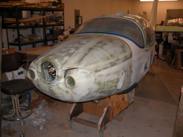

and the
problems
personally
There was a chap flying in Canada whose name escapes me with a Honda/
CAM100.
Will...that would be Alex Bowman who flies out of Nanaimo, BC...he has
the CAM125 which is built around (I believe) a mid-80s Honda Civic
engine...and he's been quite satisfied w/ performance, ops, and
maintenance. He flew it to the EAA show at Arlington, WA back in 2004
or 5, and I've seen it at a fly-in at Pemberton, BC alongside Peter
Timm's Classic. Alex is now in his late 80s and has had some medical
issues which, I believe, have been the sole reason for why he has not
been burning holes in the sky w/ his Europa...it remains a low-time
aircraft, but I much admire what he has achieved. Incidentally, he
built his plane where he lives on a small island "off the grid", and
true to form, the manufacturers of the CAM engines have evaporated.
Though the success rate for auto engine conversions for aircraft use
may be low, Alex's CAM125 installation along w/ his Airmaster CS prop
has been one of the success stories...of course, it would be more
convincing to be able to point to say 10 Europas thus powered, each w/
a thousand hours and still going strong. Some listers may recall that
w/ the demise of the original Europa company, I attempted to assemble
a group of FWF'less builders to utilize Alex's production cowl molds
and experience w/ mating the CAM125 to the Europa, but alas, that
never happened.
Of course, auto engine conversions are a subset of the question of
whether or not one may choose to deviate from orthodoxy...anyone so
interested can do some web searches and find any number of scholarly
papers and descriptive narratives on the pros and cons of doing so.
For myself...as I continue my XS mono powered w/ a derivative of a
Subaru (the RAM Performance 140 hp, MPEFIed engine w/ an Autoflight
helical-geared PSRU)...I spent about 15 months molding the cowls,
designing and fabricating the mounting frame, ditto for cooling and
tuned exhaust systems, plus temp & pressure sensors...176# "wet" but
excluding cooling & exhaust systems.
I find that a high tolerance for ambiguity has been essential...
I will post test/performance data when available.
I trust that there's a place in the Europa community for the
occasional deviant,
Fred
