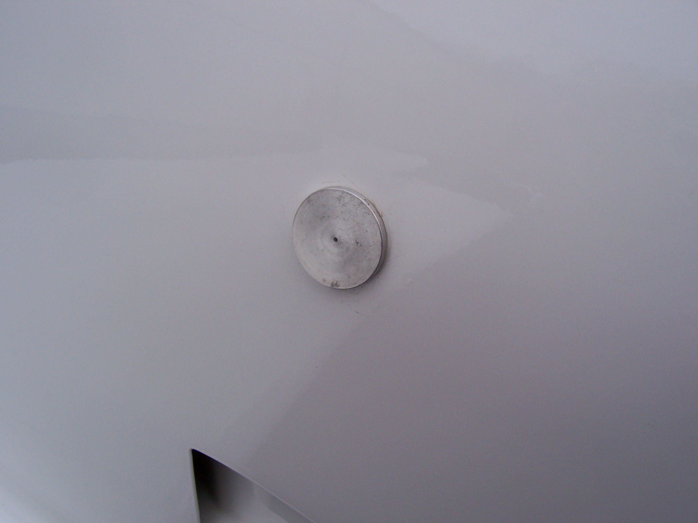

PostPosted: Mon Dec 26, 2011 9:06 pm    Post subject: Dynon Skyview Airspeed Calibration... Reply with quote
The problem is with your static port. Check out this link.
http://www.kilohotel.com/rv8/rvlinks/ssec.html
Bill B

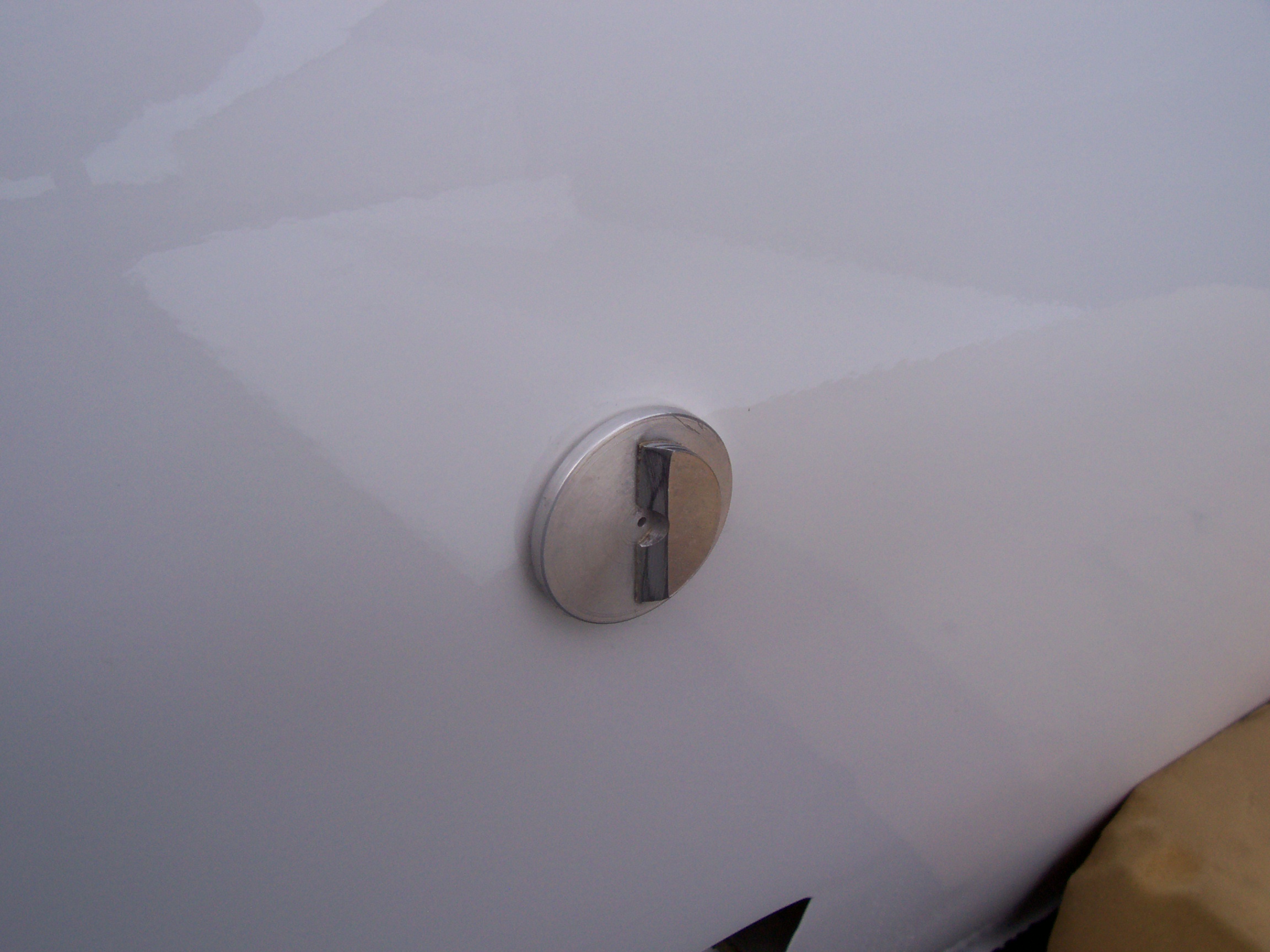

PostPosted: Tue Dec 27, 2011 6:06 am    Post subject: Dynon Skyview Airspeed Calibration... Reply with quote
12/27/2011
Hello Matt, You wrote:
1) "Are there Pitot line "attenuators" like for RF in coax?"
Not pitot tube line attenuators, but both attenuators and augmentors in the
form of wedges before or after the static port portion of the pitot - static
system that can be used to tweak airspeed (and altitude) indications.
2) "But *fast* is a head scratcher. If there's no electronic configuration
parameters to adjust, what do you do?"
See this posting to the aeroelectric list for a more complete explanation of
the use of wedges to adjust airspeed indications:
http://www.matronics.com/searching/getmsg_script.cgi?INDEX=88398860?KEYS=static_port?LISTNAME=AeroElectric?HITNUMBER=9?SERIAL=0431117943?SHOWBUTTONS=YES
A bit of search around in your Matronic's archive system on pitot static
systems and airspeed, particularly any posting on this arena by Kevin
Horton, will reveal a host of material for thought and action.

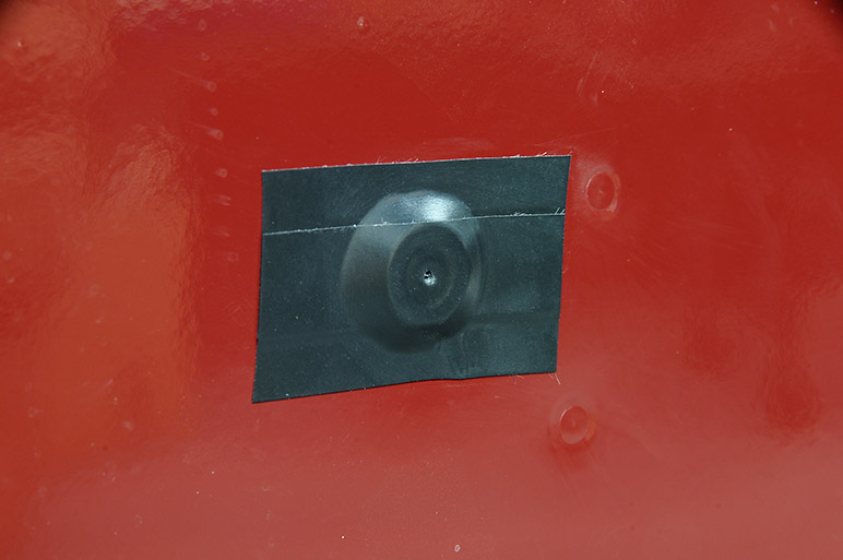

PostPosted: Tue Dec 27, 2011 8:34 am    Post subject: Dynon Skyview Airspeed Calibration... Reply with quote
Matt,
Agree with others the symptoms indicate a static problem, specifically the
location is producing a vacuum when moving.
While introducing a "controlled leak" in the pitot side might fix the
airspeed error, probably at only one airspeed, it wouldn't fix the altitude
error also produced by static error.
Two very simple things you can do to confirm the problem and start toward a
solution.
First on takeoff set the altimeter to an exact division. Note as you speed
up and rotate if the altitude changes, even a little. Higher altitude
implies dynamic vacuum at the static port(s) which will produce the effect
you describe, lower altitude means dynamic pressure.
As a test, tape a wedge, or even a block such as a short piece or two of
tongue depressor, behind the port(s). If your error decreases you are on
the right track and set for a little cut and try with wedge size and
placement. Before starting be sure to have accurate error measurements.
Use the spreadsheet mentioned by others to get wind independent actual true
airspeeds. Or you are welcome to the spreadsheet I developed from the same
formula with 4 leg input. The 4th leg provides redundant information to
indicate the quality of the input data.
Tom Kuffel, CFI

PostPosted: Tue Dec 27, 2011 8:51 am    Post subject: Dynon Skyview Airspeed Calibration... Reply with quote
On 2011-12-27, at 11:12 , racerjerry wrote:
If the airspeed is reading too HIGH, a quick & dirty solution is to install a controlled leak in the pitot system. Install a “T” in the pitot line and use the third port as a drilled jet to vent to cabin air. Begin with a #80 drill bit and open up. For calibration, extend the new line (plastic tubing) into the cockpit so your co-pilot can make adjustments in flight.
If the airspeed is reading too, it is quite likely a problem with the static system. This could be a static system leak, or a poorly designed or located static port. Errors in the static system will affect both airspeed and altitude, so it is much better to find and fix the static source problem than it is to create a pitot leak too.
If you were to fiddle with the pitot system to fix the ASI indication (or provide ASI adjustments, as some EFIS systems allow), you would still have errors in the altimeter, and these can be safety of flight issues. The TCAS systems on larger aircraft provide guidance to avoid collision with you based on whatever altitude is reported by your transponder. If you have static system errors, the TCAS system may be giving commands that increase the risk of collision.
Static system leaks on RVs often produce ASIs that read about 10 kt too high, so the first thing to do is a static system leak check. Another common problem is flush mounted static ports on RVs, but this typically leads to ASIs reading too low.
Kevin Horton

PostPosted: Tue Dec 27, 2011 9:22 am    Post subject: Dynon Skyview Airspeed Calibration... Reply with quote
Matt, I've got a couple of thoughts: The pitot / static system depends on
the static port being true ambient pressure, which is actually pretty
difficult to achieve in airflow. If you've got the port(s) in a spot that
generates a slight positive pressure on the static side you will
de-calibrate the airspeed to the low side, if there's negative pressure at
the port airspeed will read high. On the C172SP I rent there's a 1/8" high
lip on the fitting right beside the static hole. As the lip is at an angle
to airflow, I presume they dial in the static system by rotating the fitting
so the angle gives the correct pressure at the port for a specific speed
range. I've read somewhere (perhaps the Bingelis books) about making
adjustments to the static port by laying strips of tape in front of or
behind the port. As an example, the area in front of the windshield on a
stock car is a high pressure area where they take the induction to the
engine, I would suggest laying down a few thicknesses of tape behind the
port to start. Then again if your port is in an area of laminar flow,
tripping the flow in front of the port may have the same effect.
I believe once you have a modification that works you can make a permanent
'fix' that would be more efficient than a bleed port in the line.
Hope this helps.
Gerry

Listers,
Thank you for all the great suggestions on resolving this airspeed issue! I
took
a look at the static ports on the RV-6 today and found that they are done
using
a flush head screw with a hole drilled in the center on either side of the
fuselage. They do *not* protrude from the side of the plane at all. They
are
totally flush (see attached picture). Just for fun, I whipped up a couple
of quick test deals using a 3/16" washer and some electrical tape. I poked
a
1/16" hole in the center of the tape and then put the washer centered over
the
static ports on both sides of the fuselage (see attached pictures). Then, I
went flying on this beautiful December 27 day in California!
I didn't have time to do any real scientific multi-leg testing, but I was
amazed
that the True Airspeed is now falling in a much more believable range
compared
to the GPS-derived ground speed. On one cross-country leg, I had an exactly
90 degree crosswind component and the True Airspeed and GPS Ground Speed
were
tracking exactly the same. Yahoo!
Obviously I need to do some additional, more scientific measurements and
probably
come up with a slightly more "permanent" washer arrangement, but the early
returns are very promising! Smile
Thanks again for all the great feedback!
Matt

Hello Matt, Attached are pictures of the two static ports on the foward
fuselage sides of my KIS TR-1:
0599 is the plain static port on the right side of the fuselage.
0602 is the same basic static port on the left side of the fuselage, but
with a self made aluminum wedge installed on it.
Since the wedge is installed aft of the opening in the static port it has
the effect of slightly increasing the static pressure that this port is
sensing and sending to the rest of the static portion of the pitot static
system. This slight increase in static pressure, in the airspeed indicator,
balances out or reduces the effective force being applied to the indicator
by the air pressure coming in from the pitot tube. The result is that the
airspeed indicator indicates a slightly lower airspeed than it would without
the wedge.
A wedge applied before the static port opening would have the opposite
effect.
Plan on doing a lot of test flying to get your wedge(s) fine tuned to
accomplish what you want in the way of airspeed reading without
significantly adversely affecting your altimeter readings.
My thinking is that it is more important to have the airspeed reading what
it should be in the approach speed arena rather than the cruise speed arena.
