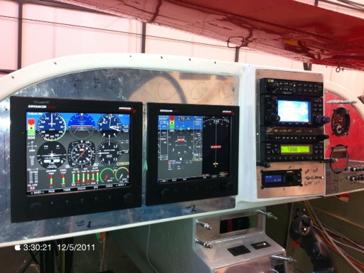

Hi Andrew
Send me a note anytime. If I can help, I will. Here are the answers to your questions:
1. No. I have internal battery backups in the EFIS screens. I made a deliberate decision to eliminate any high power switches related to avionics etc.
2. I have 2 X AF4500's, and a center stack top to bottom (PMA8000B audio panel, Garmin GNS430 WAAS, Garmin SL30 NavCom, Garmin GTX 327 Txpndr, TruTrak RV10 autopilot)
3. See attached. I will take a few more and send later (after I put the panel back on).
4. My concern was that I did not want to install steam gauges / "normal" backups if at all possible. By having dual EFIS screens with battery backups and independent AHRS, I have complete redundancy. Although I have contemplated adding an Airspeed / Altimeter / T&B as backups, I didn't see the payback for the expense. I also have a Subaru engine that has added a few interesting twists. The engine is powered by two independent buses each with its own PC680 battery. The switches controlling the engine and related components are all lever lock mil-spec Honeywell - the best I could find. The buses also have their own circuit breakers (they are on the right side of the panel). Should the need arise, I can take both batteries off line so they are dedicated to the engine. I can also isolate the power to the engine (in the event of a fire etc). Effectively, the VP-X controls everything except the engine.
5. I purchased my cables from Tim at Approach Systems (Fast Stack). Given the cost, why would you want to build your own. Tim's cables have superb quality. Besides the potential for screwing up on home-grown cables is enormous. There are are a lot of pins to be mapped. Tim also provides very detailed info on the cables and how the pins are mapped. Seeing this, I can't imaging doing this on my own - I just wouldn't know where to start.
6. I started out with a VP-100. I considered a VP200 but realized that a) it duplicated much of what appears on my EFIS screens b) I didn't have the panel real estate. After I purchased the VP100, VP came out with the VP-X that integrated with the AFS EFIS. I talked to Marc at VP and he agreed to let me swap the -100 for the -X.
I goggled the PAR100EX. It looks very nice. For my install I would still go with the PMA800B. I like the features including the cell phone interface / music interface etc. As well, I wanted a redundant NavComm. The PAR100EX doesn't have the Nav side. For IFR, I need two independent sources of navigation, The GNS430 WAAS is one, the SL30 is the other. That being said, I also have another non-TSO'd WAAS puck GPS receiver I plan to install.
Something else you may not know. There is an AFS specific autopilot head made by TruTrak. It is very simple as the advanced features are controlled by the EFIS and not the AP head. I had originally ordered the TruTrak RV10 AP but later changed to the AFS version of TruTrak and saved some $$$$.

Hi
This is one topic that I can add a bit of perspective. I have just powered
up the avionics on my -10 that uses a VP-X integrated with am AFS 4500
EFIS
screens with the avionics backbone being provided by Approach Systems Fast
Stack. No smoke and lots of pretty displays!
All the wiring was done by me, myself and I. Although I have read
everything
on the VP-X etc, I was amazed at how simple the wiring was done. With Tim
Hass's Fast Stack, I was left with wiring sensors, power lead, antennas
etc.
I started slowly as I was learning as I went but by the end I was pretty
confident as to how things would turn out. There is still a lot of work
involved in wiring - I was surprised about the amount of wire that goes to
the tail.
After seeing how the VP-X spins up on the EFIS, how easy it is to define
circuits and how they operate, how the number of high energy wires being
switched was reduced (all the VP-X switches are to ground), I can't
imagine
using a traditional bus bar for my avionics etc. It was beyond cool
watching
the avionics turn on, box by box, as I changed the VP-X configuration
settings on the EFIS.
With any system, it is wise to think about failure modse. I my case, if
the
VP-X fails I need only replace the box. Even if this happened in flight,
my
EFIS screens have internal backup batteries so it shouldn't be a huge
issue.
A final note, the support from Marc (VP) and Tim (Approach Systems) has
been
stellar. Both have been very helpful getting up a steep learning curve.
Cheers
Les

Hi Andrew
your
questions:
avionics
etc.
panel back on).
backups
each
related
so
engine
except the engine.
it
go
said,
Cheers
Les

> etc.
> to
> the tail.
> imagine
> watching
> the
> my
> issue.
> been
> Cheers
> Les

I am flying the same configuration as Les except I have the AFS AP (TT with different software).  The Static and Pitot are plumbed into both EFIS units and the AP.  GPS receivers are also wired into both EFIS units and the AP as well.
Holding the AP Engage button on the stick for 3 seconds gets you into AP stand alone mode (heading and alt hold).  Pressing the EFIS button on the AP couples the EFIS and AP together to allow the Flight Director in the EFIS to command the AP.  Works very well.
Jim C

[quote]I am flying the same configuration as Les except I have the AFS AP (TT with different software). The Static and Pitot are plumbed into both EFIS units and the AP. GPS receivers are also wired into both EFIS units and the AP as well.

Neither the TruTrak, nor the Trio, will fly an ILS without coupling to an EFIS.
If you get them with the GPSS/GPSV options, they will fly an LPV approach without an EFIS. They need the GPS signal, of course, to do this.
Your EFIS needs to have an ARINC interface to couple to them for the ILS.

Not entirely true. The Trutrak Sourcerer has the capability. But whether
the additional expense is worth the added value is another discussion.
Check out the following table.
http://www.trutrakap.com/autopilot2_2.html
Bob Leffler

My TT VSGV has a switch (mine(AP signal source)) which allows (1) track and
pitch synchronization, altitude hold; (2) LNAV VNAV with the Cheltons and
(3) LNAV with the GRT Sport.

I also have a similar configuration using a pair of AFS, TT AFS AP, VP200, etc. I have a switch next to the AFS TT AP that will switch ARINC inputs from the AFS units to the GTN650 so in addition to the AP alt/hdg mode I can drive the AP directly from the GTN if I want.

By itself no, but when coupled with the AFS efis or other ARINC input yes.
> as well.
