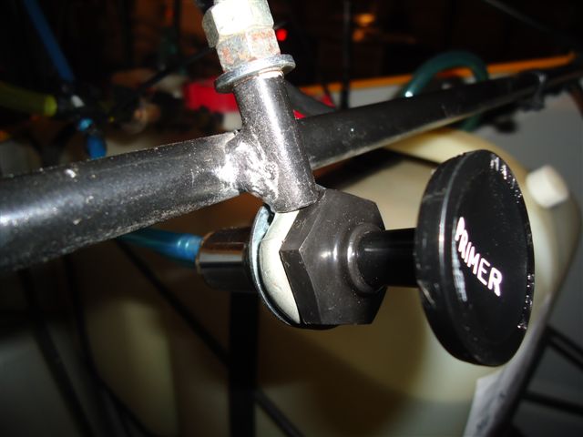

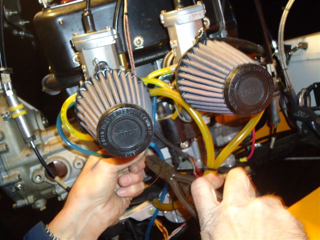

PostPosted: Wed Nov 30, 2011 4:00 pm    Post subject: Primer Kit Installed Reply with quote
503 Rotax Kolb Firestar

Hi Dennis,
Was your 503 hard to start?
Does it also have a choke?
David d.
David D/Kolbers:
Don't think the 503 has choke, but an enricher.
The enricher does primarily the same thing a primer does, shoots a rich load
of fuel into the intake.
There is an enricher jet and an enricher well built into the float bowl of
the Bing carb. With the throttle closed and enricher pulled full on, the
idle circuit is bypassed. As soon as the engine turns over, the contents of
the enricher well are sucked into the engine and the engine will operate at
a richer mixture through the enricher jet. If the throttle is not closed,
the charge in the enricher well will not be sucked into the engine.
If you don't read the operators manual and use the proper procedure the 503
will be difficult to start without a primer in cold weather. However, do it
correctly, and she will crank every time.
Bing uses the same basic enricher system for all the Rotax two strokes and
four strokes.
Personally, I don't want any fuel lines routed into the cockpit.

PostPosted: Thu Dec 01, 2011 7:01 pm    Post subject: Primer Kit Installed Reply with quote
Kolbers,
When the FireFly was pushed around by the Rotax 447, I used the enricher to
get it started. It was a pain in that in cold weather, it took too many
pulls to get the engine started. Even though I pumped the carb bowl full of
gas, a few times, I pushed the FireFly back in the hangar because I could
not get it started. After reading up about the engine, I found that the 447
spark jumps both plugs at the same time. I re gapped the plug to a lesser
gap and things improved.
When I changed to the Victor 1+, I had the same carburetor, a Bing. I
mounted a push bulb on the float bowl. While the FireFly was in the hangar,
I would open the valve, squeeze the press bulb two times, close the valve,
and then pull the propeller through two compressions. Then I would pull the
plane out of the hangar, get into my gear and into the cockpit. By priming
early, it gives the gas plenty of time to vaporize inside the crank case and
the cylinder. Never fail, the engine would fire up on the first or second
turn of the crank. The nice thing about this primer installation is that
there are no long connecting tubes to the cockpit.
With the MZ 34, I installed the same system on the Tillotson carburetor.
This time I used a ready made push bulb rather than one scavenged from a
dead weed wacker. The start process is the same as described above, and the
engine fires the first time over.
If you would like to see these setups the Bing primer may be found at:
http://jackbhart.com/firefly/firefly89.html
And the Tillotson at:
http://jackbhart.com/firefly/firefly153.html
I do not believe there is any need for concern about shooting enough gas to
prime an oil injected engine. The amount is quite minuscule. Also, when I
tore down the 447 and the Victor 1+, I was amazed as to how much oil was
inside the engine.
Jack B. Hart FF004
Winchester, IN
