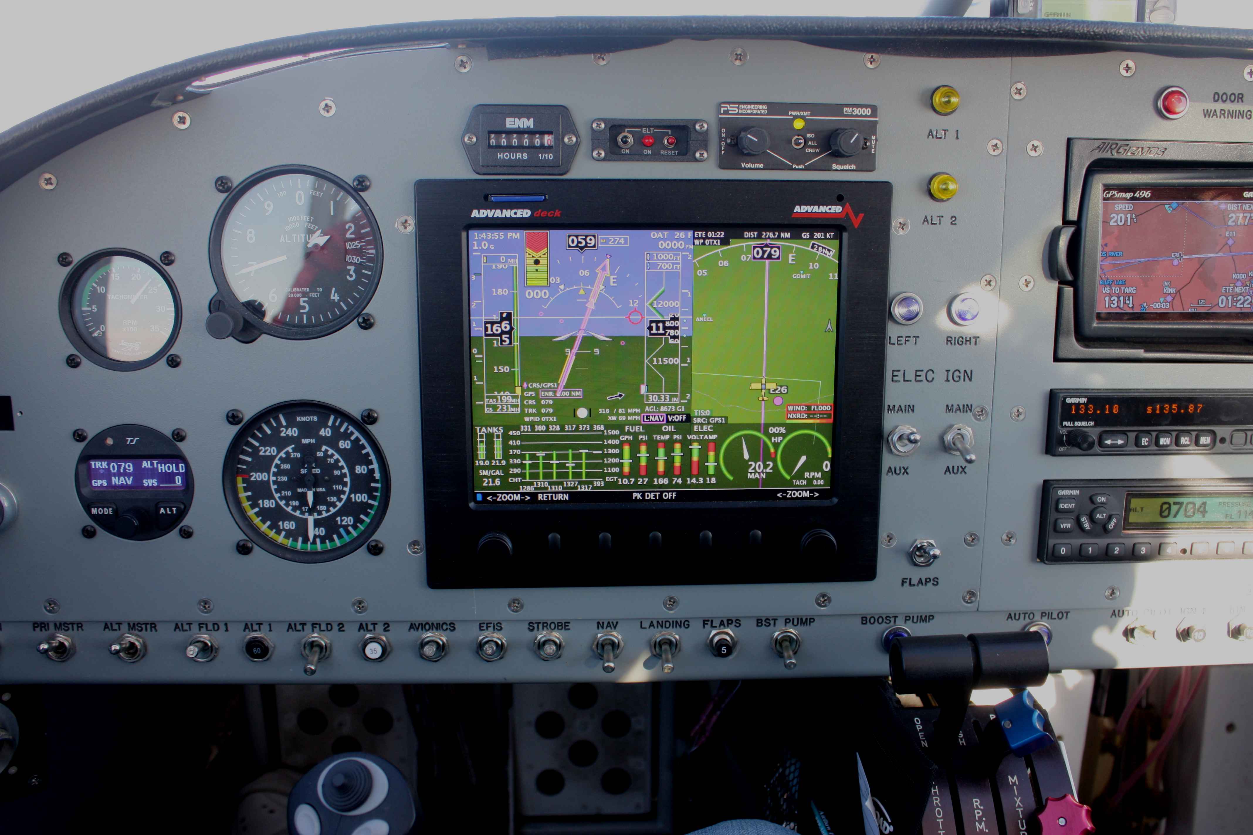

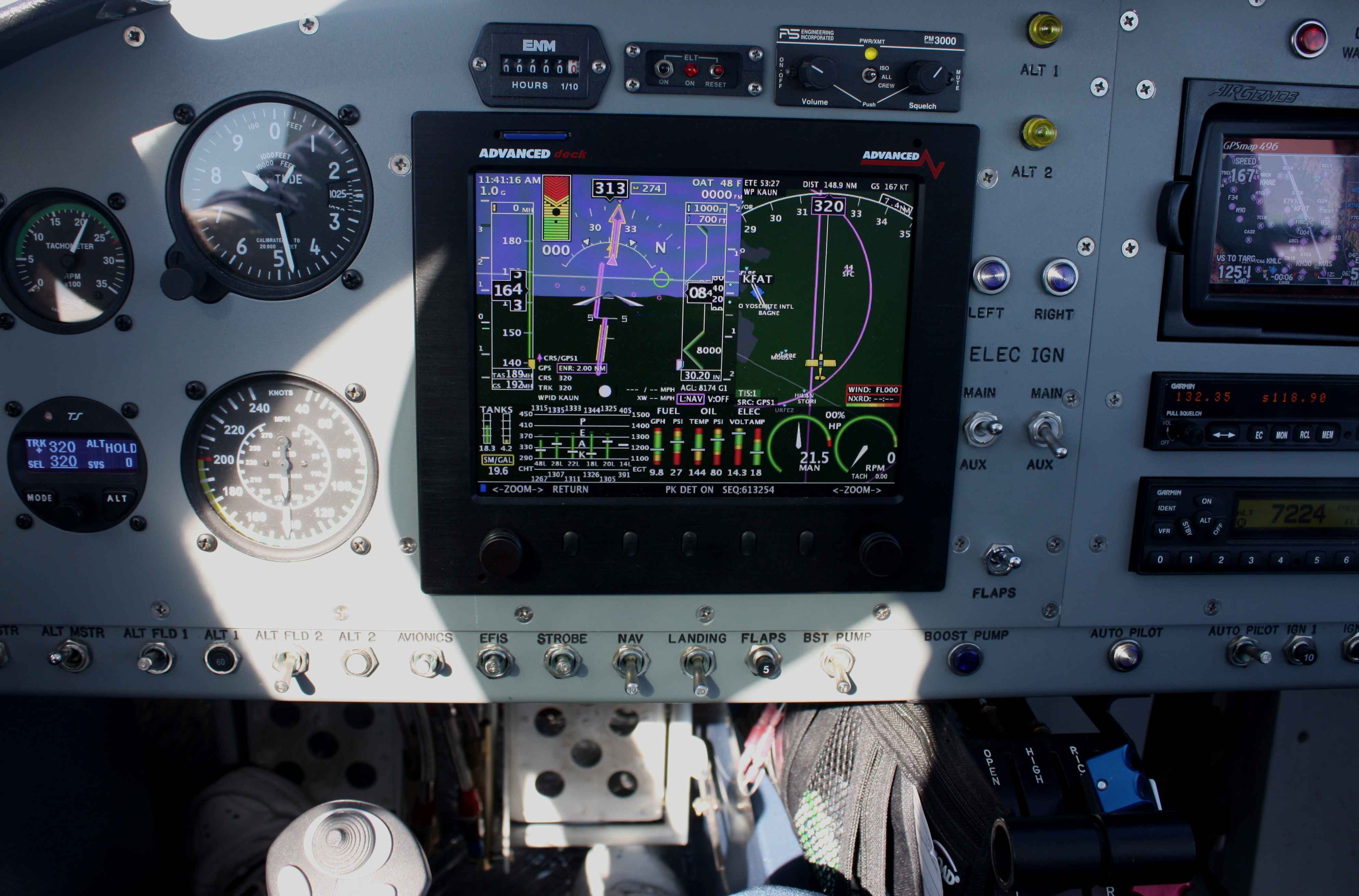

Had to chime in here.... flying back to TX last Sat from SoCal I was informed halfway that conditions were terrible... winds at destination 30mph gusting 45, and the airport I was landing at it also meant a 60 degree crosswind landing... all that coupled with a low, very low, left main tire. (which later meant wheel pant repair) In an attempt to reach home before dark, I ran an rpm setting 200 higher than I normally do. (and yes, I normally cruise at 2,100rpm.... 3 blade MT, and lot's of hp) Attached is a pic of my panel during the last part of the trip.... 2300rpm, 20.2mp, 10.7gph, 21.6mpg, 166mph IAS, 199mph TAS, 231mph GS, 11,700', winds 316 at 81mph with crosswind comp of 69mph.
This is a great plane!!!!!!!!!!!!!!!
OK, I threw in a pic taken several days before while I was heading from Fullerton to the Sacramento area, showing my normal cruise rpm of 2,100, 21.5mp (not WOT, ck quadrant), 8,500', 9.8gph, 19.6mpg, 164mph IAS, 189mph TAS, 192mph GS.
Two weeks ago we ran some speed checks with 3 RV10's and an RV7. 5,500', wot, 2,500rpm.... all 3 10's were within 3mph, with the fastest achieving 207TAS... the 7 was about 5mph slower. We did not work on mixture or see if a slightly higher rpm would have increased the TAS.
